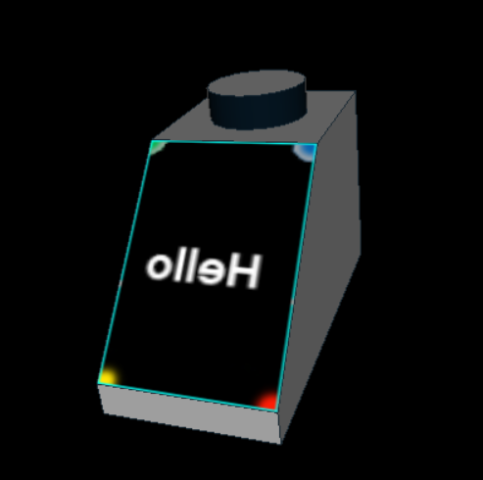

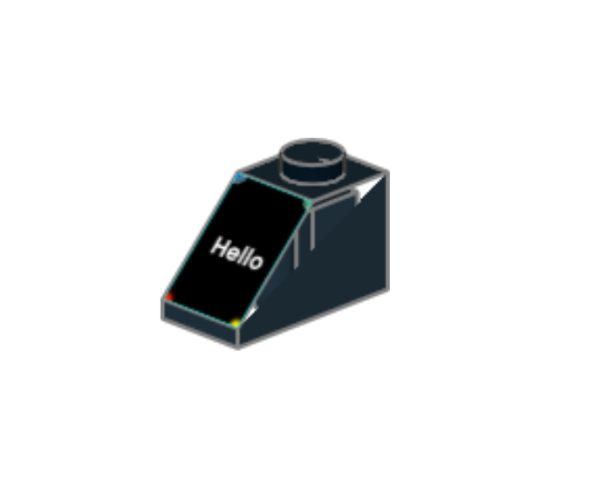

Sticker in LDCad
[Image: ldcadsticker.png]
Sticker in LDView:
[Image: ldviewsticker.png]
Sticker in LPub3D
[Image: lpub3dsticker.png]
LDView 64bit version is 4.4 Alpha 2
LPub3D version is 2.2.2
Reply

Now I'm trying to do the same thing with 3040b Slope 45 ° 2 x 1 but although I thought it was easier I have some problems.
I'm trying to put a sticker on the sloped surface of the piece. As you can see from the attachments, I managed to fix it but it's the image in flipped.
It is true that I could flip the original PNG, but I would like to understand my mistake
Where am I doing wrong?
thank you
Attached Files Thumbnail(s)
.png   slope_1_sx.png (Size: 4.09 KB / Downloads: 125)
.dat   3040b_hello.dat (Size: 764 bytes / Downloads: 8)
Reply
RE: Creating stickers
#32
(2020-09-05, 13:25)Simone Wrote: Thanks Magnus. Now 93606 is ok.
thank you
This fixes it:
(I swapped the X coordinates.)

ps: on LDcad or LDView works perfectly but when i open with LPub3D i got this (attached) strange transparent behavior.
Reply
#38
(2020-09-07, 17:52)Simone Wrote: ps: on LDcad or LDView works perfectly but when i open with LPub3D i got this (attached) strange transparent behavior.
What renderer are you using for LPub3D? If it is LDView, LPub3D has a privately built LDView executable included with it. That executable isn't based on any official (or even Beta) LDView release. That could be causing the problem. If you're not using the LDView renderer, switching to it might fix the problem (although it will slow things down by a lot, AFAIK).
Reply
#39
(2020-09-07, 18:35)Travis Cobbs Wrote: What renderer are you using for LPub3D? If it is LDView, LPub3D has a privately built LDView executable included with it. That executable isn't based on any official (or even Beta) LDView release. That could be causing the problem. If you're not using the LDView renderer, switching to it might fix the problem (although it will slow things down by a lot, AFAIK).
Yes sorry, i forgot to mention. I'm using internal LDView render. Could it be a setting inside it?
Reply
#40
(2020-09-07, 19:19)Simone Wrote: Yes sorry, i forgot to mention. I'm using internal LDView render. Could it be a setting inside it?
I'm not sure how it would produce such an image. You might try tweaking the "Offset" setting in the Textures section of the Primitives tab.
Reply
#41
(2020-09-07, 20:42)Travis Cobbs Wrote: I'm not sure how it would produce such an image. You might try tweaking the "Offset" setting in the Textures section of the Primitives tab.
Same result.
I think i will use a custom part with box5.dat and the image to show the sticker applied over the part instead of directly replacing the oblique face of the part with the image file.
Thanks
