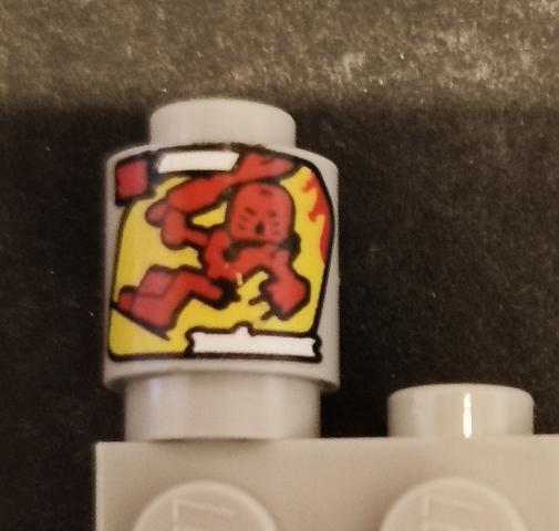

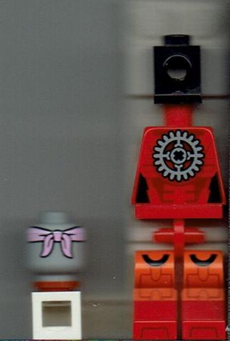

I would like the pieces of the Tahu cosplayer from collectible series 29.
Bionicle Cosplayer, Series 29 [Set Inventory]
Required pieces:
I tried scanning the pieces with my printer["Scan"] and took pictures of them["Image"].
Attached Files Thumbnail(s)
.jpg   Tahu_Scan_Canister.jpg (Size: 18.73 KB / Downloads: 260)

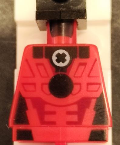

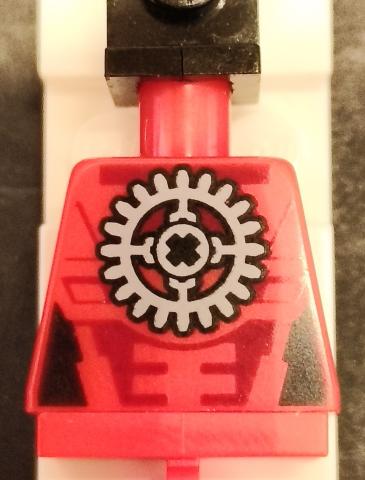

The canister and the Mask are still missing. Also the Torso does have a neckmark as you can see in my pictures and the one on Bricklink.
Reply
RE: Bionicle Tahu Cosplayer from Series 29
#4
Canister is done:
https://library.ldraw.org/parts/52402
Torso now has black neckmark.
Reply

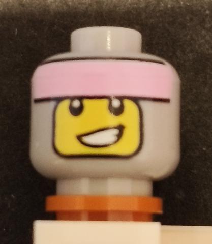

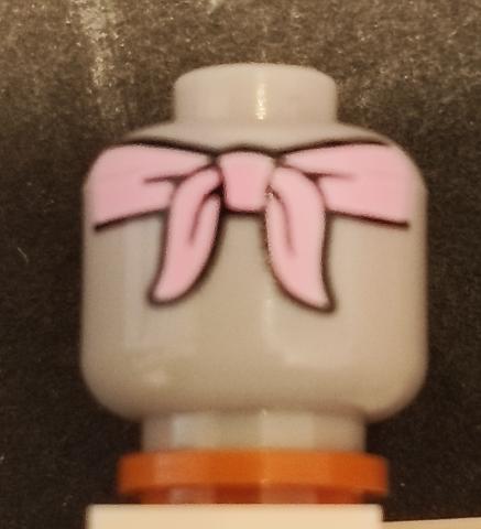

Are you working on the mask?
Reply
#7
(2026-05-05, 16:08)Magnus Forsberg Wrote: Are you working on the mask?

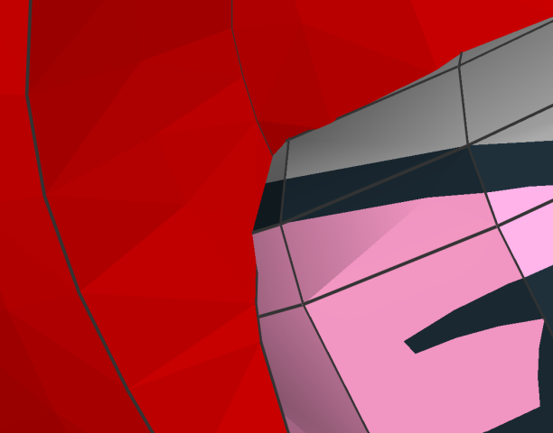

I've started, but didn't go far (only split in half)... There's quite a lot of collisions with a minifig head in the BIA mesh which I'd say need to be fixed:
Not too mention the front half is supposed to sit close to the head underneath and needs to be adjusted to the head's cylinder.
Any tips on how to approach this? I also wouldn't mind if anyone else wants to take over.

Put a partial head insdie:
1 9 0 4 0 0 0 8 0 -6.4 0 -8 0 0 t04o6250.dat
1 9 0 4 0 -8 0 0 0 -6.4 0 0 0 -8 t04o6250.dat
1 9 0 4 0 13 0 0 0 23 0 0 0 -13 2-4cyli.dat
See where surfaces cut into the cyli, mark vertices match nearly the 16 sided geometry select them and select either "move to nearest edge" or "surface" this will adapt the shape to the head
Reply
#9
(2026-05-05, 20:24)Gerald Lasser Wrote: Put a partial head insdie:
I often do the same, but with hi-res prims.
Select the vertices inside the cyli/headshape and use the Scale tool to resize/move in the xz-plane with the Manipulator placed in origo.

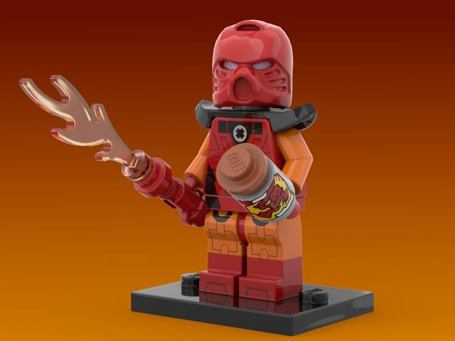

And done - https://library.ldraw.org/parts/52435
Thanks to Gerald and Magnus for help  Smile
And he's complete:
.ldr   71052-3 BIONICLE Cosplayer.ldr (Size: 1.37 KB / Downloads: 4)

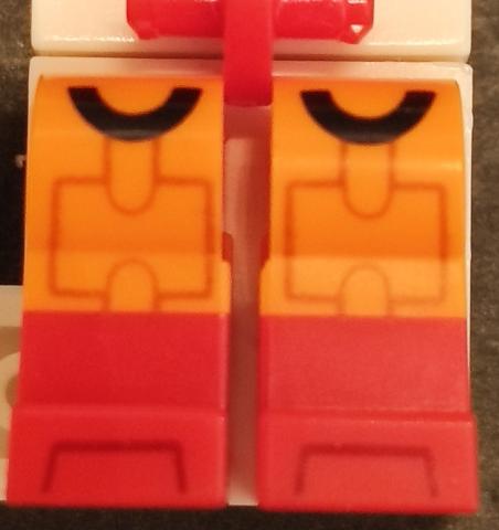

I just looked at the Bricklink page for the legs and there their main colour is defined as red and not orange.
Reply
#16
(2026-05-08, 18:46)Hageta Wrote: I just looked at the Bricklink page for the legs and there their main colour is defined as red and not orange.
That's because BL for some reason insists on using the hips colour as base colour, not the legs. In LDraw hips are only colour 16 if they match the legs colour (which they don't in this case). The "Boots" for dual-molded legs also never count as the base colour here.
Compare:
https://library.ldraw.org/parts/40688
https://www.bricklink.com/v2/catalog/cat...7#T=C&C=36
EDIT:
Lego also mostly considers leg assemblies to be based on the colour of the legs (some exceptions though):
https://brickset.com/parts/6117803/mini-...-2-140-106
Remember, Bricklink isn't offiicial - and in this regard they are likely wrong Rolleyes
