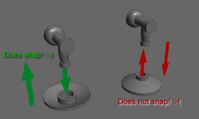

4599a tap does not snap to 4740 dish 2x2 inverted at the top, does work at the bottom?
I was trying to achieve the one with the red arrows to create a lamp :-)

RE: Part Snapping missing/errors
(2023-03-24, 6:51)Jaco van der Molen Wrote: 4599a tap does not snap to 4740 dish 2x2 inverted at the top, does work at the bottom?
The hole was capped for some reason, fix:

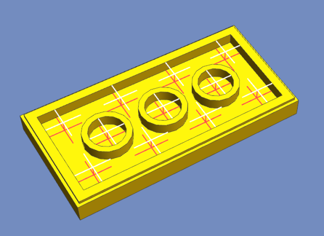

44861 is missing info at the bottom like a normal 1x2 plate for 2 studs.
Add 0 !LDCAD SNAP_INCL [ref=3023.dat] ?
Hello,
87079: Snaps with the stud at the midlle are missing.
I added this line in 87079s01.dat:
Code:
0 !LDCAD SNAP_CYL [gender=F] [caps=one] [secs=R 6 4] [pos=0 8 0] [grid=C 3 C 1 20 20]
Reply
44861: Snaps are missing.
I added for test this line in 44861.dat, it seems to work:
Code:
0 !LDCAD SNAP_CYL [gender=F] [caps=one] [secs=S 6 4] [pos=0 8 0] [grid=C 2 1 20 0]
Reply
