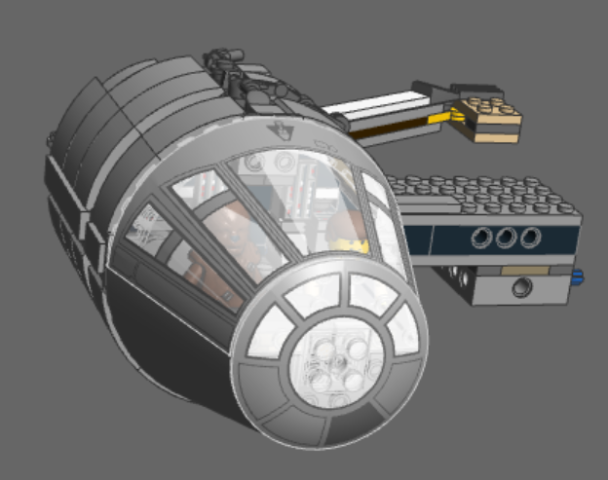

Hi all,
Because I probably won't ever build it for real, I began digitizing the 75192 Millennium Falcon just for fun.
Reaching step 378 I ran into something strange which is I think an illegal connection?
The red liftarm won't fit here?

(2017-10-13, 12:18)Jaco van der Molen Wrote: Reaching step 378 I ran into something strange which is I think an illegal connection?
Confirmed... If I build the model in LDCad, the distance between pins is 42.4 ldu. Situation is worse with LDD: pin holes are a bit closer to top of Technic brick (a well known LDraw approximation) making the diagonal pins even further apart at 43.1ldu. In any case, LDD refuses to fit the diagonal beam!

Thanks.
Isn't strange that LEGO uses a connection like this?
I know they use illegal connections now and then, but still it is strange.

Are you sure it's "illegal"? It seems to me purely by looking at the picture that the click hinges should have plenty of give to make this connection work fine in real life, without deforming parts over time.
The connection with real parts is under no stress at all, the 3L Liftarm slides on the axles like butter. No force at all
I was not sure it was illegal, but since it didn't fit digitally I thought it might be.
With real LEGO it is surely possible, like Gerald says.

May not be illegal strictly speaking, remains that the 3L beam pulls on the L-beams. Either there is some stress in the parts (since there are many connexions (thus play) implied in the link, the stress may be low) or the angle between Technic bricks is not 90°...
