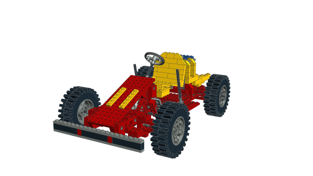

853/956 - Auto Chassis
#2
853/956 - Auto Chassis (main model)
My first model submission!
No known errors, but a few spots are "unbuildable" in LDraw, because they depend on the natural tolerance of physical plastic (common among early Technic/Expert Builder sets):
  • Where the steering tie rods join the control arms, the pins are not "in click" with the 2x4 Technic plates.
  • The inclined 1x8 Technic bricks of the steering column are slightly out of alignment at their upper connection point.
  • The rear suspension "struts" are well out of alignment at their upper connection point, such that the 4L axles are considerably compressed into the toggle joints.
OMR compliant, made with LDCad 1.6c (under Wine)

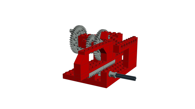

851/952 - Tractor
Tractor with one of the equipment attached. The other ones are also in the file.
Tyres in color Rubber-Black
OMR compliant according to MPDcenter tool.
Build with MLcad 3.51

#5
In equipement 1 the driving axle
Code:
1 0 -25.5 -48 -5 0 -1 0 1 0 0 0 0 1 3705.dat
is placed too high, it collides with top plate and doesn't enter in the hole of bottom plate.
Also, since the model is shown with equipment 1, I think that the attachment beams of tractor should be configured/rotated so that the small wheels of equipment 1 sit on floor (and so that the top 40t gear properly mesh with driving crown gear of tractor)

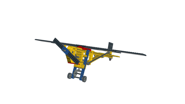

852 Helicopter /954 - Sky Copter
Added updated file.
.mpd   852 - Helicopter.mpd (Size: 21.52 KB / Downloads: 11)

#7
(2020-03-21, 8:26)Philippe Hurbain Wrote: In equipement 1 the driving axle
Code:
Hello Philippe,
Thanks for the comments. Apologies for the 'mess'. I clearly missed some clean-up actions.
This file should have corrected all your points and more I found myself.
When get files added to the overall list of official models?
Regards Allard
.mpd   851 - Tractor.mpd (Size: 20.72 KB / Downloads: 10)
Reply

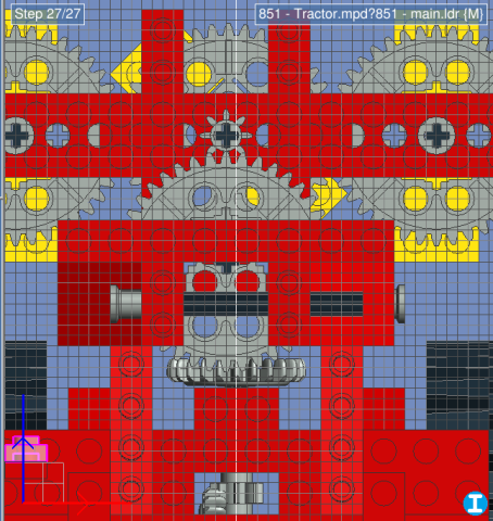

1. Here's a screenshot from LDCad showing what I mean:
I've displayed a grid at a 5 LDU resolution (and hidden one 1x8 beam for clarity). Looking down from above, the tractor itself is visible at bottom, and the attachment (your submodel "equipment1") is at top. The vertical white grid line shows the center of the model; notice that the main tractor is properly centered, but "equipment1" is one grid square too far to the left. Since its current position is <-320 16 1625>, all that's necessary is to add 5 to the X coordinate, so: <-315 16 1625>.
2. Not sure how it's done in MLCad since I don't have the program, but it should be quick and easy, and worth doing. Depending on what program others use to view your model, it might give strange results when we try to rotate the view, if it's set to rotate around the model's origin. (I personally like to set the Y-origin at the lowest physical point of the model, so it sits on the "floor" and doesn't appear to be floating when I go to render the model, but that's not the only way to do it.)
3. Meshing gears isn't necessary for OMR purposes, it's really just your own discretion as a modeler. While I always mesh everything when building Technic models in LDraw, it was a presumption on my part that most other modelers do as well, but perhaps the practice isn't as widespread as I guessed. (It seems many of the good folks here put their considerable skills into tackling behind-the-scenes issues, allowing less accomplished LDraw-ers like me to focus on things like meshing gears.) :-)
4. Yes, MPDCenter won't know if you're building a set that has alternate builds, but there are specific guidelines for naming those files. However, I'm not actually sure how that would apply here—most Technic sets have 2 or more totally different models you can build, but in this case it's one model with a variety of alternate attachments (and then I think the set has a couple of fully standalone alternate builds as well).
So I'd open that question to the community as to what's the most appropriate naming scheme for this set. I think my personal solution would be to have all the attachments included as submodels in the final building step, at the appropriate positions, and then to "comment out" all but the one currently being displayed. All of that together would then be named "851 - Tractor - Main model.mpd". Then if you decided to build the two standalone models, they would be named "851 - Tractor - Power saw.mpd" and "851 - Tractor - Wood splitter.mpd"—or whatever you determine those models to actually represent!  Big Grin

(2020-03-26, 4:06)N. W. Perry Wrote: 1. Here's a screenshot from LDCad showing what I mean:

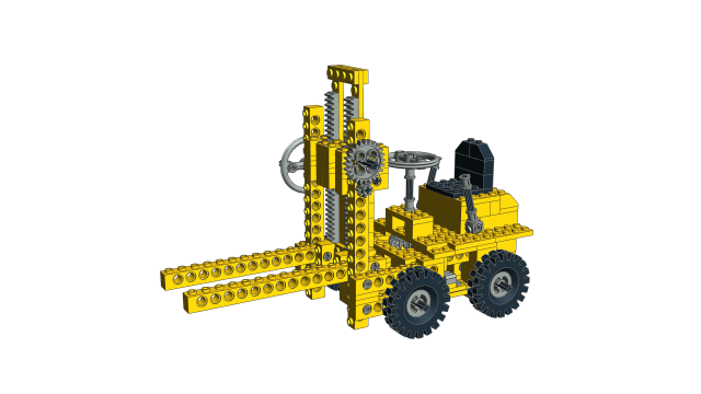

850/950 Fork-Lift Truck (1977)
Original model by Merlijn, added missing axle, corrected tyre colour, and rearranged submodels based on movement
.mpd   850-1 - Fork-Lift Truck.mpd (Size: 12.21 KB / Downloads: 6)
OMR compliant
Missing items: none
Known errors: slight (2 LDU on each side) collision, between the vertical beam, bottom pins and top axles
Reply

#23
(2024-02-04, 13:28)Takeshi Takahashi Wrote: Known errors: slight (2 LDU on each side) collision, between the vertical beam, bottom pins and top axles
Ah, yes…you have to scale down the tower of 2x2 bricks a little bit in order for it to fit properly. (You can either spread the 2 LDU across all seven bricks equally, or as I did, just make two of them 1 LDU shorter and hide them in the middle somewhere.)  Wink
Also, you'll find that in real life, the fork assembly isn't perfectly perpendicular, but sits at a slight angle inside its mechanism. And of course the whole thing does tend to bind up a bit; it's just one of those cases where the real-world model depends on some amount of physical flexibility that LDraw simply doesn't represent. That was common in early Technic, after all!

850 - Fork-Lift Truck
#25

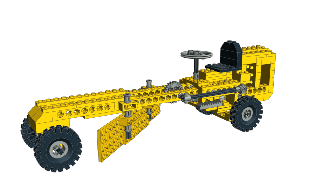

850/950 Fork-Lift Truck - C-Model Grader
Original model by Merlijn, corrected tyre colour, and rearranged submodels based on movement
.mpd   850-1 - Fork-Lift Truck - Grader.mpd (Size: 9.58 KB / Downloads: 4)
OMR compliant
Missing items: none
Known errors: The blade is not connected sufficiently to the body frame (in real life it's owing to part flexibility)
Reply
851 - Tractor
#26
851/952 Tractor - B-Model Crank Machine 1
.mpd   851-1 - Tractor - Crank Machine 1.mpd (Size: 3.86 KB / Downloads: 3)
OMR compliant
Missing items: none
Reply

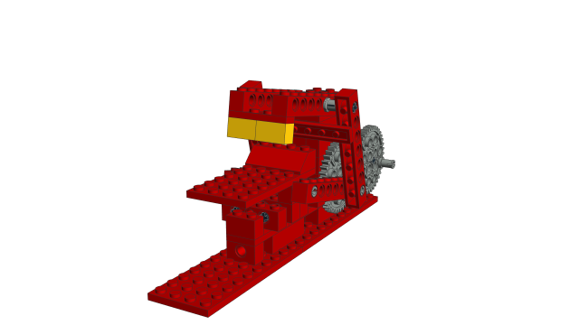

851 - Tractor
#27
851/952 Tractor - C-Model Crank Machine 2
.mpd   851-1 - Tractor - Crank Machine 2.mpd (Size: 4.84 KB / Downloads: 4)
OMR compliant
Missing items: none
Reply
RE: Technic 1977
#28
I feel like these last two would be "simple" enough to try out LDCad's new interactive animation feature—for those clever enough to do so. Wink
(By the way, why does the first crank machine have a transparent 1x2 brick? Is that in the file itself, or just the preview image?)
Reply
RE: Technic 1977
#29
(2024-02-10, 2:58)N. W. Perry Wrote: I feel like these last two would be "simple" enough to try out LDCad's new interactive animation feature—for those clever enough to do so. Wink
Yes, it's very nice to be animated!!
Thanks for pointing out the wrong colour.
The purpose was to adjust the angle of the rack and I've forgotten to set it back again.
Reply
852 - Helicopter
#30
852/954 Helicopter - B Model Prop Plane
.mpd   852-1 - Helicopter - Prop Plane.mpd (Size: 9.31 KB / Downloads: 4)
OMR compliant
Missing items: none
Known errors: Slight collisions at pin/axle connections (in real life it's owing to part flexibility)
Reply
853 - Car Chassis
#31
853/956 Car Chassis - B Model Go Kart
.mpd   853-1 - Car Chassis - Go Kart.mpd (Size: 19.24 KB / Downloads: 3)
OMR compliant
Missing items: none
Reply
