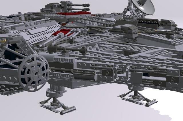

I am currently working on 3 improvements for the buildinginstructions.js project. One of these is more realistic rendering.
![[Image: IDarxYs.png]](https://i.imgur.com/IDarxYs.png)
As you can see, I have a lot of work ahead of me. Currently there are 3 tasks which have to be finished:
1) Proper computation of normals. In the picture above I have used the built-in normal calculation. There is another post on this forum where we discuss normals, and I will be implementing a custom normal calculation which ensures hard edges where we have lines of type 2.
2) Rendering of special materials. I am currently pretty happy with how rubber is rendered. However. Having proper rendering of chrome and metal will require both a proper environment map, and other textures. My hope is that I will end up with some really neat looking parts, but this is unfortunately a new area for me.
3) Reflections, shadows and floor should be added. There are tutorials showing how to do this with three.js and I just have to find the time to do this right... unless someone else want to take it on and create some pull requests

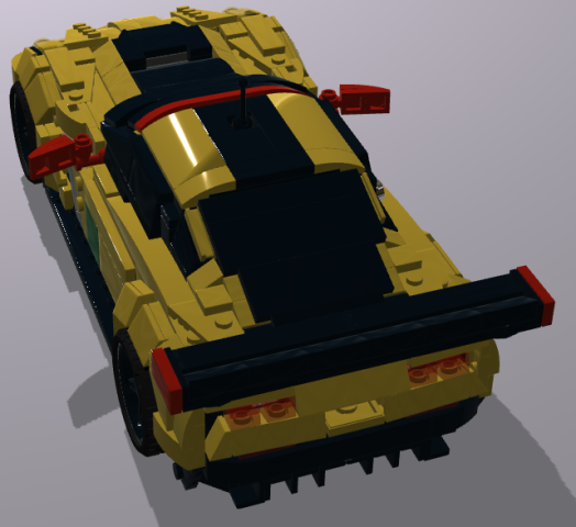

An update!
![[Image: vjKiqBV.png]](https://i.imgur.com/vjKiqBV.png)
You can see some artifacts on the flat yellow parts. It is by modifying these artifacts and adding "damage" to the parts that I expect to get the rendering to become more realistic. Also. I will add a pattern to the ground, different lights, and other improvements. Slow and steady

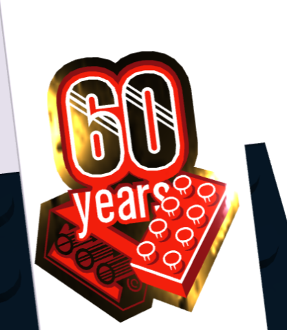

EDIT. A closeup showing the level of detail up close:

I have now added materials for the various types of colors, and it is time to test it out on brickhub.org to find errors before suggesting to use it in OMR.
It works fine for some models:
![[Image: 343.png]](https://brickhub.org/i/data/343/343.png)
(Hint: The keys "QWEASD" can be used to move the lights - I am still working on proper scene controls)
While other models show that there are issues with some parts:
![[Image: 476.png]](https://brickhub.org/i/data/476/476.png)
I believe the issue here is due to my custom UV generation.
Furthermore. I would like to use normals to generate stud logos in order to preserve loading and rendering performance. As you can see, I have turned stud logos off for now since it has a major impact (hundreds of triangles per stud).

I have added the following piece of code (almost similar to changing ldconfig.ldr):
Code:
if(colorID === 0) {
params.color = 0x1B1B1B;
params.roughness = 0;
}Giving the following result:
![[Image: gP8IzvR.png]](https://i.imgur.com/gP8IzvR.png)
I have previously moved the lights around to achieve proper reflections and nuances in the black surfaces, but we cannot expect users to do so.
I had hoped the directional light would help here, but is works poorly on curved surfaces.
This is what I can achieve by adding lights to highlight the black parts:

(2019-09-04, 1:36)Orion Pobursky Wrote: The UCS Falcon crashes the tab on my desktop when brigl is used. With LDBI, time to render is reasonable and it doesn't crash the tab.Yes, works great, especially considering the size of the model. As it nonetheless takes some time to load (about 30 seconds here), would it be possible to get some form of progress bar?
http://omr.ldraw.org/files_ldbi/347
Otherwise, got a display problem, the feet of the Falcon sometimes disappear:
(2019-09-04, 6:52)Philippe Hurbain Wrote: Yes, works great, especially considering the size of the model. As it nonetheless takes some time to load (about 30 seconds here), would it be possible to get some form of progress bar?A progress bar would be a great idea, but my attempts to create one have failed as it has decreased the loading speed significantly. I will have to check StackOverflow for some pointers.
The 'Feet' issue might be due to the debth buffer issue mentioned earlier. I have also observed it with other large models which are not on wheels.

I find the Metallic colours very strange.
This is a Metallic Gold print. http://omr.ldraw.org/files_ldbi/1182
And the Chrome colours is also off.
Image 2.png (Size: 83.4 KB / Downloads: 169)
This is Chrome Silver, looking very black. http://omr.ldraw.org/files_ldbi/640
(2019-09-04, 15:33)Magnus Forsberg Wrote: I find the Metallic colours very strange.
That is due to the loading issue with environment map.
See the model on Brickhub here: https://brickhub.org/i/386
And it looks like this:
This is fixed.
