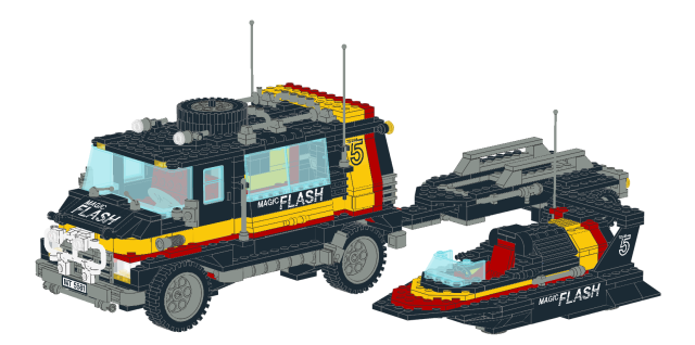

#37
5581 - Magic Flash
.mpd   5581 - Magic Flash.mpd (Size: 44.82 KB / Downloads: 3)
File OMR compliant.

5581 Magic Flash (US) / Magic Flash (UK) - 788 pcs. (box) / 787 pcs. (instructions)
*Release: August 1993
*4 of the 787 pieces are used only for the B-Model
*instructions show stickered doors, yet sealed copies can be seen containing printed ones
*back of the box shows a C-Model of a flatbed truck (no instructions available)
.mpd   5581 - Magic Flash.mpd (Size: 39.11 KB / Downloads: 0)
Added missing stickers and reworked file.
EDIT: Minor Header fixes, added Extra Parts and alternative Scene.
OMR compliant
Known issues:
*Back of Boat's driver seat should go further in the panel according to box photos. This is not possible without slightly bending the plastic, so is avoided here since the clipping looks weird in rendered bricks.
*using the printed doors included with the set instead of the stickered ones from the instructions
Missing items: none.

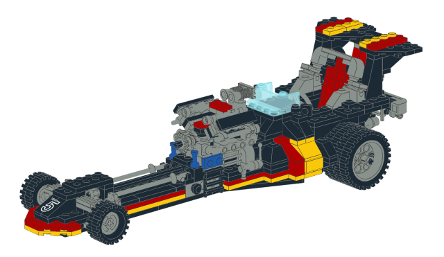

5581 Dragster (Magic Flash B-Model)
*using 403 of the 787 pieces, including 4 not used in Main Model (51.2%)
*using 1 of the 16 stickers, a STAMP that is used on a single piece in the Main Model
*first of three dragster models in the Model Team line
.mpd   5581 - Dragster - B Model.mpd (Size: 21.33 KB / Downloads: 0)
OMR compliant
Known issues:
*the "Motor Cover" 3-piece assembly vanishes in the last step of the instructions but can still be seen on box photos, although with the 1x2 plate on bottom, not top - file uses instruction version, sub-filed to easy edit out if desired
