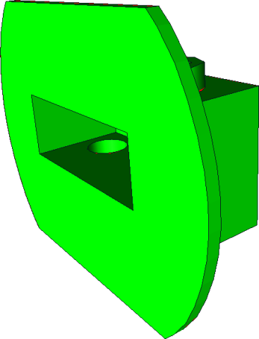

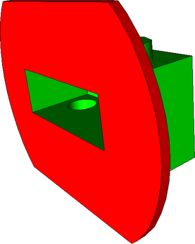

Thank you for your work!
I would like to encourage you to add 1 more thing to your files: BFCing.
We just recently achieved the milestone of making all official files BFC compliant.
All corrected parts have been uploaded to the parts tracker.
Your files now are the only ones which are not BFC certified.
Therefore it would be desirable to get them BFCed.
To help you understand what that means, I wrote a Wiki article for you, and for other new LDRAW authors:
https://wiki.ldraw.org/wiki/BFC
I hope that after reading it you understand this request a little better.

Hi Steffen.
Thank you for the review.
I will try and see if I can make it BFC certified (I'm color-blind, so red/green might not be the easiest for me to work with, but we'll see).
I do think I understand what's behind BFC, since I'm a developer myself (I've made my own graphics-primitives, which includes winding-rules, thus it's likely similar, just for 3D).
In my opinion - from what I understand, BFC is a good idea and the right way to go.
It's always a good idea to optimize data-formats so processing is as easy for the CPU as possible.

(2018-03-29, 2:03)Jens Bauer Wrote: I will try and see if I can make it BFC certified (I'm color-blind, so red/green might not be the easiest for me to work with, but we'll see).
In LDView's settings you can disable the "green front faces" option, so the default color is used instead of green. Then you can choose the default color to be something that contrasts better.
Quote:It's always a good idea to optimize data-formats so processing is as easy for the CPU as possible.
Nowadays it's the GPU that does the back face culling, rather. Even if there's no graphics card the CPU chip has an integrated GPU. But having consistent winding has other algorithmical uses besides just rendering.

(2018-03-28, 1:07)Steffen Wrote: I would like to encourage you to add 1 more thing to your files: BFCing.
I've played around with LDView. Fortunately, the red/green colors are not a problem for me. Smile
-I'm not completely sure I've understood the BFC correctly.
Eg. I would have expected the motor housing needed to be green on the outside and on the inside.
Eg. a standard 4 x 2 brick would not be 'red' when seen from the bottom, right ?
I've made two files for the rear-part of the motor, they should illustrate what I mean; they're attached as two images (in order to make things a little easier).
One of them must be wrong. Wink
If I understand it correctly and the current housing is correct, then 'x2' (first attachment, left) should be correct.
If the housing should actually be red on the inside, then 'x3' (second attachment, right) should be correct (I actually like x3 better, but that doesn't mean it's right).
-So now I'll need to ask you, in order to get a correct understanding; which one of them are correct.
Note: I spent a couple of hours correcting the file I submitted, rather than re-applying my changes to the current one; I also added some thickness to the part where it joins with the main motor housing.
Attached Files Thumbnail(s)

Hi Jens,
Right one is correct. By "inside" we mean "inside plastic", not "inside an assembly made of several parts". Hope I'm clear, feel free to ask otherwise Wink
Reply

(2018-03-30, 9:33)Philippe Hurbain Wrote: Hi Jens,
That's the most clear explanation I've ever heard.
Thank you for making it easy to understand. Smile
-So I take it that ideally, the motor housing should be green when looking on the 'inside of it'... =)
Reply

#24
The right, green one is correct.
You should never see a red surface on the outside of a closed mesh, when you're rotating it and looking at it from the outside.
Both my reworked parts, 6216ma and 6216mb are missing a closed mesh.
I'll add a closed surface to 6216ma.

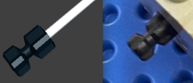

I made 3 primitives for axles:
Axle Endcap
Axle Endcap with Hole
Axle Groove (now renamed)
(Max kindly pointed out to me that the quads on the ends are warped; this was not intended and I'll attempt to correct this for next submission).
The end-cap for the motor has been updated too.
I submitted updates for the two axles, which use the above 3 files:
Electric Technic Motor Plastic Axle (1982 variant)
Electric Technic Motor Plastic Axle (1977-1979 variant - also use by gearbox)
At some point, I expect to 'close' the unseen end of both plastic axles.
(Sorry for the many extra re-submissions; I wanted to make this submission of as good quality as I could).
