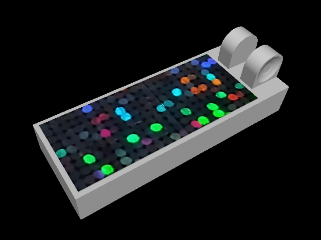

Is it allowed to use a mixture of "normal" patterns and Texmaps to simulate the effect of certain holofoil stickers (like in 6991 or 6949)? Seems a bit unusual to me, but in theory it works.
Here is a quick test shot I made:
Probably need to get a better image of the foil and get the scaling more accurate to the real stickers. Perhaps this single image can even be used on all those "dotted" stickers.
However, there seem to be issues when exporting to other formats or Stud.io Confused

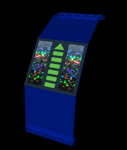

Hello Chris,
the contemporary use of patterns and textures in the same area has already been done in the official sticker 6148328q.
For the appearance in Stud.io or other viewer with no textures, the faces occupied by the texture have been colored with a Simplified/Neutral pattern.
Massimo
Reply
RE: Textures for Hologram Stickers?
#3
(2024-11-22, 22:31)Massimo Maso Wrote: Hello Chris,
Massimo
What you are talking about here is the texmap fallback geometry, which does not get rendered when texture mapping is enabled. The original question appears to be about having geometry that is present in a texture-mapped area (that is NOT marked as being fallback geometry). To the best of my knowledge, this is allowed.
