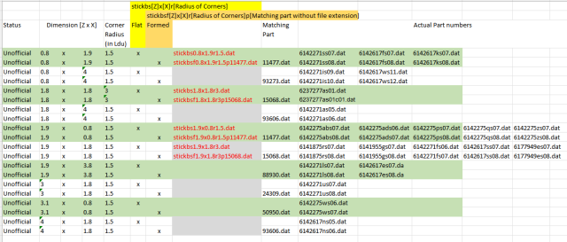

Hi there,
as written in our core group, I would like to suggest to create primitives for the sticker backsides, which are rectangular and have rounded corners (formed and unformed) So they can be used for different stickers.
For now we the same backside several times with different subfile names.
I made a little Excel sheet. Which is linked
.xlsx   Sticker Bottom List.xlsx (Size: 11.26 KB / Downloads: 6) to this post. Please note that sometimes the same sticker backside is mixed up with X and Z coordinates. This needs to be fixed in any case before the release. (Do we have rule, that stickers should be made in a way that Z x X contains a X value which is always equal or greater than Z (as we do for most of our bricks)?
Suggestion for the name:
flat sticker backsides: stickbs[Z]x[X]r[Radius of Corners]
Means: StickerBackSide[Z]by[X]radius[Radius of Corners]
formed sticker backsides: stickbsf[Z]x[X]r[Radius of Corners]p[Matching part without file extension]
Means: StickerBackSideFormed[Z]x[X]Radius[Radius of Corners](Matching)Part[Matching part without file extension]
Any thoughts on this?
/Max

RE: Sticker bottoms - Subfile or Primitive
#2
(2022-06-21, 21:36)Max Martin Richter Wrote: Do we have rule, that stickers should be made in a way that Z x X contains a X value which is always equal or greater than Z (as we do for most of our bricks)?
No and, per the spec, we should not. The sticker should be oriented "such that the top of the pattern aligns with the +Z axis." This means we could have a 1.5 x 3.5 sticker and a 3.5 x 1.5 sticker depending on the pattern.

A couple of thoughts:
- I think subparts are a better location for these. Yes, I know about the documentation question but nothing is stopping us from have the same proposed naming convention.
- Regardless of the above, formed backs should always be subparts. The primitive folder should be kept as clean a possible and I don't want a bunch of obsolete prims because the part number changed.
- IRL all stickers have rounded corner but corners should only be modeled rounded if the rounding is more that the default.
Reply

May I bring this thread back to focus as we are going to have some parts almost ready for admin cert I would really like to avoid to have identical subparts for several shapes.
Can we implement or pin the content of my excel chart as reference somewhere?
Concerning the round cornes.
As they were not present till some time and are now present, I think they should be modeled.
/Max

I updated the old table with auto generation of filenames.
Link to Google Docs
As there is already one case in the old table, where R = 3 (all others are 1.5) this variable is needed as well for the name.
I will update the table when we find a conclusion. (Of course we can discuss on this topic in April/May as well.)
