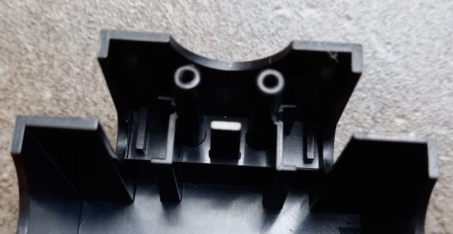

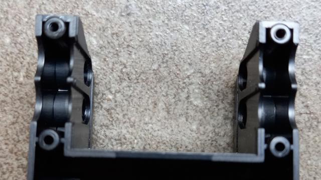

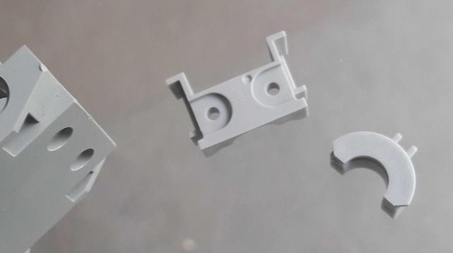

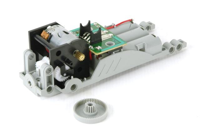

I almost forgot about the motor. 13.dat doesn't look remotely as the real parts:
Let me know if you wanna have more pics.
w.
LEGO ergo sum

Willy: thanks you very much for the pics. Of course, I will let you know if I need more.
I making it based on this http://technicopedia.com/8279.html.
Now I'm able to complete the rest axle.
To Magnus: in the website above is what I try to accomplish.

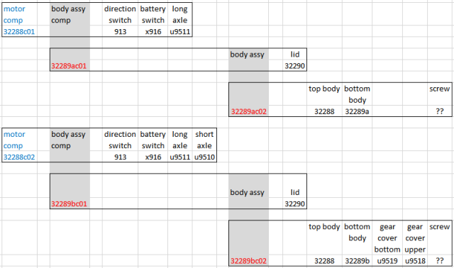

Proposed new structure of these motors.
I'm not sure of the red partnumbers. Since the uncoloured part is 32288, maybe the assembly should use that number as base.
Reply
RE: Part 32289b modifications and new parts
#16
Magnus Forsberg Wrote:Proposed new structure of these motors.
I'm somewhat sceptic to this scheme as:
* 32288c01.dat - Electric Technic Motor 4.5V  6 x 17 x  5 with Dark Grey Base Type 1
is used only in one set and exclusively in Dark Grey
https://lego.brickinstructions.com/08000/8472/081.jpg
* 32288c02.dat - Electric Technic Motor 4.5V  6 x 17 x  5 with Light Grey Base Type 2
is used only in three sets and exclusively in Light Grey
https://lego.brickinstructions.com/05000/5221/003.jpg
https://lego.brickinstructions.com/08000/8279/010.jpg
https://lego.brickinstructions.com/08000/8307/004.jpg
w.
LEGO ergo sum
Reply
#17
Ok,
Then maybe skip the middle assembly.
I want to see the top level contaning: only the movable and removable parts + a complete assemby of the non-moving body parts.
Think animation. As a user, I want to inline the top level shortcut, and then flick the switch or rotate an axle.
Reply

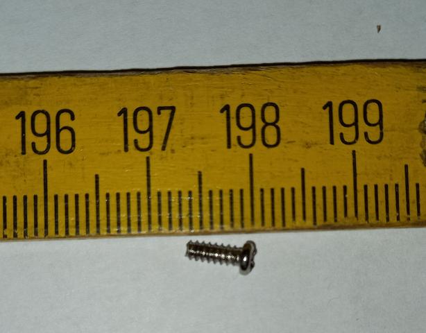

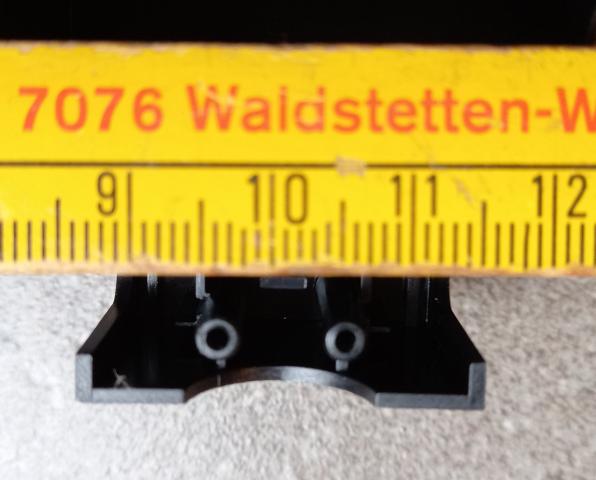

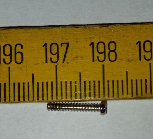

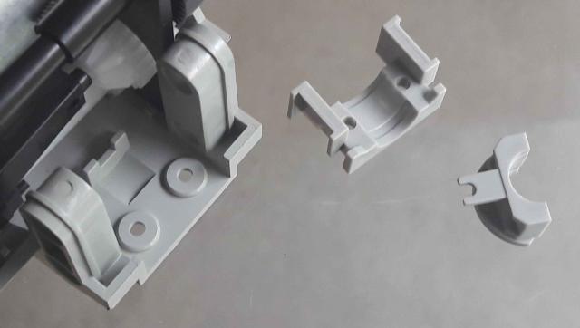

Hi everyone: I solicit your assistance on this subject:
  1. I need images of the inside of real life part 32288 to know where the screws go in order to correct the respective file.
  2. Also, need images of the motor holder with the dimension to model it.
Thanks in advance, Javier.

To me a mock-up of the screw's head would be more than enough but it's your part.
I do not think that you should add more detail to the inside nobody will ever see but rather fix:
https://www.ldraw.org/cgi-bin/ptdetail.c.../u9518.dat
and get the part shipped.
w.
#20
Willy: thank you very much for the pics. The "motor holder" I am talking about is the big black where is the gear too (sorry for the confusion):
Reply
#21
Hello: here it is the screw and the part 32288.dat modification (only the tube where the screw goes, front side):

I did the folowing "unification" of the file. Hope it can be submited to the PT.
EDIT: Updated the files.
.dat   32288bc01.dat (Size: 648 bytes / Downloads: 1)
.dat   32289bs01.dat (Size: 4.18 KB / Downloads: 1)
.dat   32288c02.dat (Size: 494 bytes / Downloads: 1)
Reply
#24
(2022-09-13, 23:09)Javier Orquera Wrote: I did the folowing "unification" of the file. Hope it can be submited to the PT.
No,
I like your 32288c02.
I think some screws are in the wrong file.
You can't have all parts in a file hardcoded to a colour.
btw,
the subfile should use the updated npeghol7a primitive. Like this:
Reply
#25
I updated the unification files to be checked/reviewed.
Reply
#26
(2022-09-16, 23:20)Javier Orquera Wrote: I updated the unification files to be checked/reviewed.
Sorry, I shouldn't encourage this. Updated parts and reviews belong on the Part Tracker.
Besides this, these parts are included in the latest part release. If you want to change them, they need to re-uploaded.
I suggest that you move on to some other parts.
