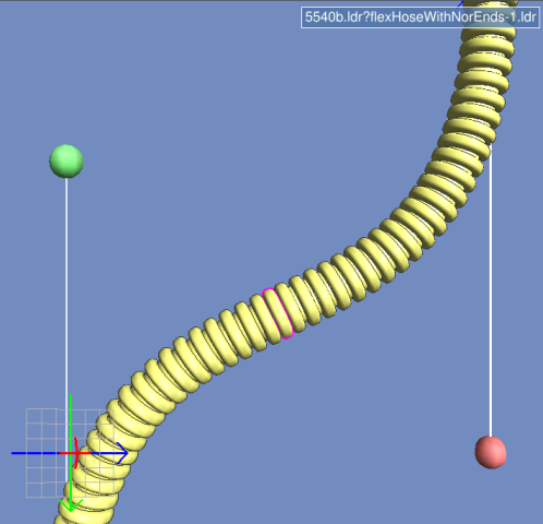

I noticed that the center segment of the hose does not have gaps on either side of it, which leaves a group of 3 rings bunched together. Is this a feature or a bug? (Or just a setting I could play with? I really haven't tried tweaking much, other than adjusting for the correct overall length of 6.6L/132 LDU/52.8mm, minus caps.)
(2020-09-02, 22:54)N. W. Perry Wrote: I'll add this here rather than starting a new thread, as it's relevant:
I'm not sure what you mean here, could you give a screenshot?
