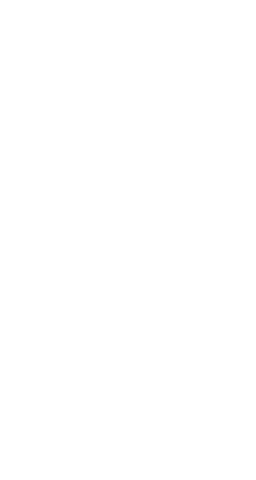

Hi all,
I have made a custom textured part for a model.
.png   93606p12_25_1240_150_DPCM_1_23_-45.png (Size: 10.98 KB / Downloads: 137)
However it does not render correct in certain steps and orientation.
See attached PDF.
Does anyone have an idea why it does not render in step 2 and does in step 3 and 4?
Thanks.

Oh, I attached the PNG but it got inlined.
I added a zip file now with PNG, LDR and PDF.

Quote:Oh, I attached the PNG but it got inlined.
...and I didn't notice because it was white on white background Wink
Completely puzzled by this one. I see the same kind of problem, but I find no problem in the part or model. I tried a gazillon of things and the problem remains the same (or worse!). I tried with another texmapped part (3960p0b) that works fine. And if I put 93606p12 and 3960p0b in the same file... 3960p0b is textured in all images and 93606p12 is never textured Sad

Quote:Could it be a memory problem? Is it because the PNG is white and transparent?
Could have been, easy try: I reduced image size by 7 (thus 50 times less pixels) and made an orange backgound. Same problem...
