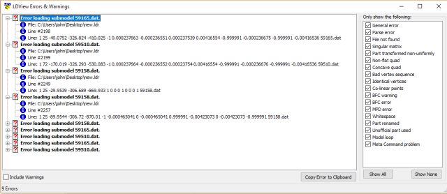

I have this file and i want to open it in ldview, it opens but it also give several errors.
anyone idea how to solve these errors ?

Looks like you have a file converted from LDD
59510  is the Battery box 919.dat, but with two lid, 918.dat. We don't seem to have a shortcut for that combination.
59165  is the Button on that Battery box, 920.dat
A complete Battery box is present as 58119.dat
59158  is the output axle on XL Motor 58121, called 47157.dat
or
59158  is the output axle on Motor 99455, called 99543.dat
Open your file in a text editor and replace accordingly.

Thanks for the help, i can now open it in ldview without errors.

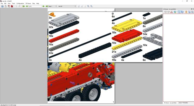

But now i want to open it in ldpub3d to make a good manual, but it does not work.
Anyone, any idea ?

What problem are you having?  I downloaded your file and opened it in LPub3D with no problems.

I rechecked the lpub3d software version and i was using the 19 version so i downloaded the 20 version, but it still is nto working.
When i open the file it will only come up the the attached screen.

Ah! your problme is simple: there is no building steps in your model so your building instructions just adds all parts (btw, THAT's a behemoth of a model!) at the first page. To create good building instructions, you have to break the model into smaller submodels and add building steps to make them buildable. That's a huge task, especially for a large model like this one that makes my editor (LDCad) crawl...
In order to help a bit, I added steps every ten parts in your model (using MLCad autostep function), resulting in a 650+ steps model. Won't be very usable, but at least you'll see what it looks like!
