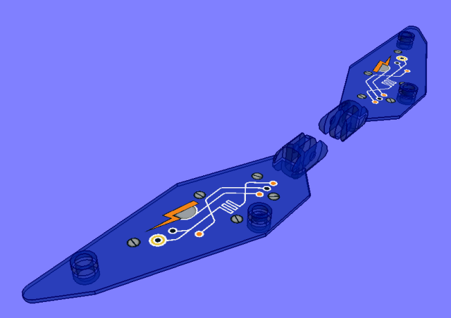

I now have a pattern ready for upload, of the small wing.
But first I want to ask if you wanted to have a go at it yourself?

(2017-04-14, 23:27)End Unsure Wrote: Are you asking me or Phillippe? And if your asking me, do you want me to try it out?
No. I'm asking you. Do you want to try LDPatternCreator and make this yourself, or is it OK with you if I upload my part to the PT?

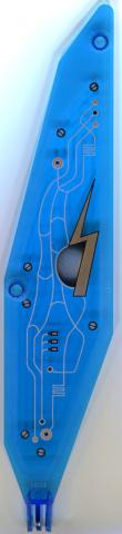

Anyway, if one of you wants to have a try to large one, here is a scan...

(2017-04-15, 16:08)End Unsure Wrote: Its good with me man,
OK then, I'll upload my files.
(2017-04-15, 16:08)End Unsure Wrote: Actually, if your willing would you also do the pattern on the large wing?
I'll start working. But the scan from Philo made me question my choise of colours. Is it solid white/orange or metallic silver/gold ?
Making patterns is a good way to start making parts. I remember my first atempt as an part author was making some patterned parts I was missing.

Quote:I'll start working. But the scan from Philo made me question my choise of colours. Is it solid white/orange or metallic silver/gold ?
Actually it's metallic silver/copper.

(2017-04-16, 10:57)Philippe Hurbain Wrote:
Quote:Making patterns is a good way to start making parts.
Yes!!!
Well thanks guys for all the help. If patterns are easy maybe I'll look into that here soon.

Done!
On the Part Tracker here
Reply
RE: Part and decals request: Insectoids, UFO, Stingray
#22
(2017-04-22, 20:50)Magnus Forsberg Wrote: Done!
You guys are awesome, I'm super excited to start using these.
