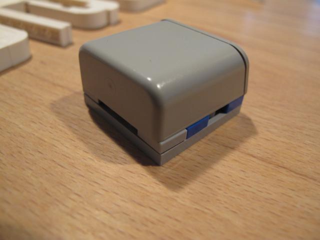

The shape is fairly simple and easy to create, but do you have other photos from different angles? Measurements?

I have this part but I need to look for it (great availability: once in Technic, three times in Belville :-)
I upload larger images and dimensions.

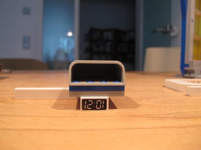

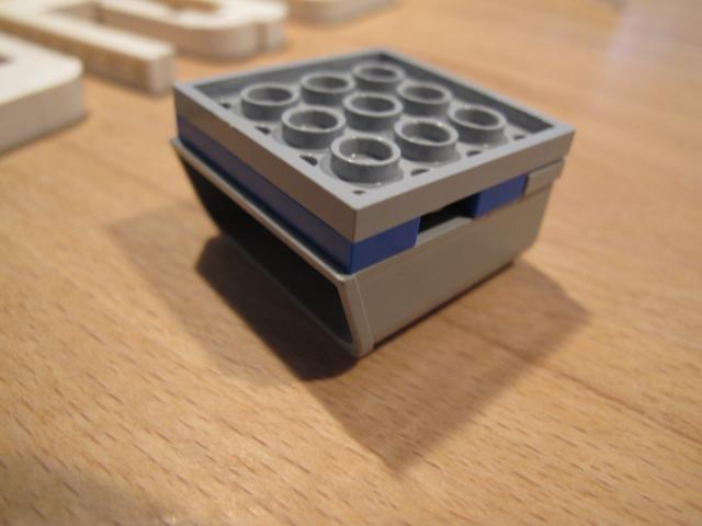

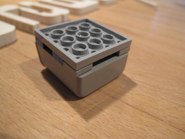

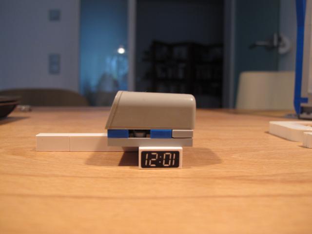

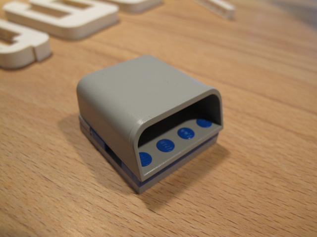

I found it! Was in "Old Gray Stuff" bin...
This part is son un-rectangular...
- The base is 4 x 4 studs extending by 1mm front and back.
- The base tapes from slightly over 4 studs (4stud + 4 LDU) at the Scoop to under 4 studs at the back (1 mm less)
- side walls are 1,2 mm, top is 1,8mm, bottom is 1,6 mm
- Around the scoop is a lip 1,4 mm wide, .2 mm high
- The part height is 13,1 mm at the back and 14 mm at the scoop (including the lip)
- Side walls are parallel.
- Radius from side to top looks to be 5mm
- Radius from the side wall to the back wall looks to be 2mm which also applies for the curve from back wall to the top.

Here are the pictures:
one more to come

#11
Last one:
