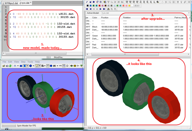

No, there is a difference.
The difference is that the same partnumber (132-old.dat) today only contains an instruction to move parts,
and a "ghost image" of where it used to be.
Maybe a picture will show it better:
Reply
Re: MLCad ~movedto buggy???
#25
I don't understand Magnus point ether, his above picture proves MLCad doesn't apply the 132-old.dat transformation as it should when doing an upgrade.
It's clearly just replacing the .dat reference while keeping the original transformation.
There are no old and or new parts there are only transformations. If you put an ~moved part in a new model it should only affect the BOM before and after the upgrade while visually remaining the same as the moved to transformation tells the parse (like any other reference) how to bring the target part into the local space of the current file.
Reply
#26
I think I can understand you all.
The rotation matrix is unaffected by the information in in the Move to-file.
I'm only looking at the actual result.
Somehow MLCad is replacing partnumber '132-old' with 'u9131'. And a correct movement takes place.
The new file '132-old' now only contains information on how to replace it with 'u9131'.
You should not use the old partnumbers.
Reply
