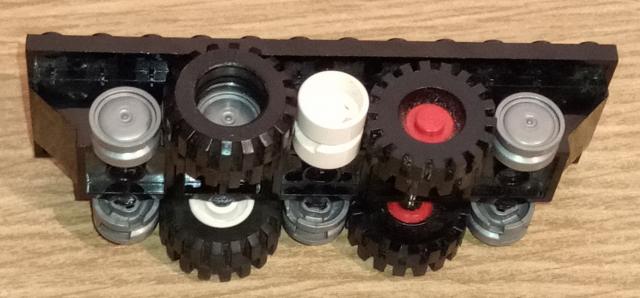

Checked the reasons for the differences im rim diameter, found errors in ancient parts:
-all wheels are touching and driving each other (some slippage, but still counts as connected)
-the 6015 fits perfectly on 93594 (and its family, which are R14 and measured -> correct)
-> the 6014 and family are currently R13 -> wrong, should be R14 too, measured are 11mm, which is R13,75
-> the 6015 outside is currently R25 -> wrong, should be R26 (to match the 40 LDU distance, also measured that)
-> the 4084 is the same outer diameter as 6015 -> wrong, should also be R26
(also remember, 4084 is supposed to be one plate bigger than 3641, which is correct at R18 -> 18+8=26)
-> is this 1 LDU difference ok as rework or do they need to be obsoleted? (lots of parts in LOTS of sets)
