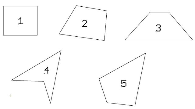

Hello,
the next question. Five quadrilaterals are shown below.
Are all variants approved according to the specification?
Greetings
Manfred
Reply
RE: Complete rework of parts and further questions
#5
(2024-09-10, 14:28)Manfred Schaefer Wrote: Are all variants approved according to the specification?
4 is a concave quad is is not allowed per the file format spec.
From the spec:
Quote:Quads must not be concave (two or more other polygons must be used instead).
#6
(2024-09-10, 15:31)Orion Pobursky Wrote: 4 is a concave quad is is not allowed per the file format spec.
From the spec:
Hello Orion,
Thank you.
I had only thought of lenses when I heard the term “concave” and didn't see any connection to quadrilaterals. Wink
I found a good description on the Internet and now know when a quadrilateral is concave, namely when both diagonals lie within the quadrilateral.
Best regards
Manfred
#7
(2024-09-10, 16:47)Manfred Schaefer Wrote: I found a good description on the Internet and now know when a quadrilateral is concave, namely when both diagonals lie within the quadrilateral.
To make it clear...
For a convex quadrilateral, both diagonals lie within the quadrilateral. For a concave quadrilateral (NOT ALLOWED), one diagonal lies outside the quadrilateral.
Reply
#8
(2024-09-10, 17:04)Philippe Hurbain Wrote: To make it clear...
Hello Philippe,
thank you for your hint. I made an error in my answer, correct is convex and not concave. Huh
I meant convex.
Greetings
Manfred

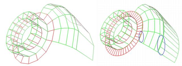

Hello,
to better understand the primitives, I took a look at Minfig Head 3626.
As I understand it, the primitives are a kind of container, which in turn contain further primitives or character instructions.
The primitives are available in three resolutions P is the standard resolution, 48 is the high or 3x resolution and 8 is the low or half resolution.
Normally the standard resolution is used, this resolution can be changed by the program for rendering, for example, if the primitive with the same name is available in a higher resolution.
I hope I have understood this correctly so far.
In the following picture I have compared a part of the minifigure head in standard resolution and high resolution. I used LDView for the images.
The high resolution was forced by the fact that I wrote 48\ in front of the primitives. I made a mistake with Stud2, I should have made this change on the lowest level.
I noticed that there are small gaps or overlaps here, because the torus t04o6250 is not available in high resolution. See the two ellipses.
Would it make sense to create them in high resolution?
I know with printed minifig heads there would have to be one or more variants, as there is no high resolution for the printed parts and the problem mentioned above would exist in the opposite direction.
Greetings
#10
(2024-09-12, 18:08)Manfred Schaefer Wrote: Would it make sense to create them in high resolution?
No. There is something I call "Too much detail". You have to take into consideration that while making a pattern you're working on it isolated from the rest, where you get the feeling that more detail would render nicely.
How many time you're lookin' at a close-up of your head in a BI or a render of a set and how much would you gain compared to the bloat of a file 4 times bigger in size? The strenght of LDraw was also that the polycount was/is reasonable.
w.
#11
(2024-09-12, 18:25)Willy Tschager Wrote: No. There is something I call "Too much detail". You have to take into consideration that while making a pattern you're working on it isolated from the rest, where you get the feeling that more detail would render nicely.
w.
Hello Willy,
I understand that there should be a good compromise in the level of detail and the number of polygons. The number of polygons also stands for the time needed for rendering.
Perhaps I expressed myself incorrectly in my question.
I don't want to replace the torus, but rather offer an additional torus with a higher resolution to avoid the above-mentioned gaps and overlaps when rendering in high resolution.
With the standard resolution, everything would be the same.
Regards
Manfred
#12
(2024-09-12, 19:52)Manfred Schaefer Wrote: I don't want to replace the torus, but rather offer an additional torus with a higher resolution to avoid the above-mentioned gaps and overlaps when rendering in high resolution.
While LDView does have an option to use high-resolution primitives when available, I don't feel that the existence of this option should encourage people to produce 48 versions of primitives that aren't needed for any other reason. I think most people who want higher quality in LDView will instead increase the curve quality setting, which applies to all curved primitives supported by LDView.
Reply
#13
(2024-09-12, 20:16)Travis Cobbs Wrote: While LDView does have an option to use high-resolution primitives when available, I don't feel that the existence of this option should encourage people to produce 48 versions of primitives that aren't needed for any other reason. I think most people who want higher quality in LDView will instead increase the curve quality setting, which applies to all curved primitives supported by LDView.
Manfred.
There is a difference here you need to understand. The primitives are not "replaced" by another high resolution primitive.
What you see in LDView is created by the "math magic" performed by the program. The "high resolution" is adjustable, and not dependant of a hi-res primitive.
Reply
#14
(2024-09-12, 20:58)Magnus Forsberg Wrote: Manfred.
Okay, I understand.
I also noticed that LDView has more than 48 elements for a circular ring at a higher resolution.
The high resolutions (48) are necessary when large patterns are involved and the segmentation would be visible or disturbing with circles.
Greetings
Manfred
Reply

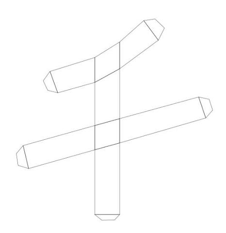

Hello,
I have now made my first attempts to create a digital pattern.
Most of the patterns used almost only triangles. However, I prefer quadrilateral.
Below I have shown a part of a pattern (Chinese character) and wanted to know whether my approach is allowed or permissible.
In reality, the sign is approx. 4 x 4 mm² in size.
I don't see any problem with the T-junction.
At what angle, other than 90°, is it no longer referred to as a T-junction?
Greetings
Manfred
Reply
#16
I see no T-junctions in your image.
T-junction is not an angle issue. It's a question about surfaces next to eachother.
Have you found the LDraw Wiki pages?
https://wiki.ldraw.org/wiki/T-Junction
Reply
#17
(2024-09-23, 15:49)Magnus Forsberg Wrote: I see no T-junctions in your image.
Hello Magnus,
Thank you for your reply. I was mainly concerned with the use of quadrilaterals instead of triangles. As I have seen some patterns that have used triangles although quadrilaterals would have been possible.
I thought that using quadrilaterals was uncommon or considered bad style.
I was aware of the site you mentioned. I try to avoid T-junctions. In the picture with the triangle and quadrilateral, there could be a problem because point D is not part of the triangle and the shapes are not connected at that point. There could then be a gap here due to rounding errors.
Greetings
Manfred
#18
(2024-09-23, 18:56)Manfred Schaefer Wrote: I thought that using quadrilaterals was uncommon or considered bad style.
Nope. In fact, when I do patterns I usually do all triangles and then run the file through DAT Header's optimizer to combine as many triangles into quads as possible.
Reply
#19
(2024-09-23, 19:37)Orion Pobursky Wrote: Nope. In fact, when I do patterns I usually do all triangles and then run the file through DAT Header's optimizer to combine as many triangles into quads as possible.
Hello Orion,
thanks for the tip. I have looked at the documentation for the program.
Using the program to convert triangles into quadrilaterals is a good idea. I am currently doing it manually in my trials. But in future the conversation of the polygons into triangles should be done automatic. The subsequent conversion to quadrilaterals could then be realized with this program.
Greetings
Manfred
Reply
