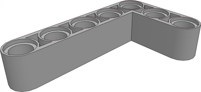

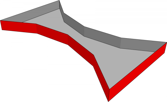

Currently it is like this (npegholes, those carvings between connection holes), with sharp ends

We've had the same debate for click hinges and the round/half round 1x1 tiles. My counter point would be that these small rounded edges at a lot of triangles for a feature that is only visible at close zoom levels. Also, developers are free to use primitive substitution to render them with "higher res".

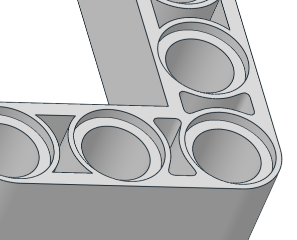

I agree that current situation is far from perfect (it's even worse for 90° angled beams where the npegholes join together), but changing this is rather daunting, as these elements are often embedded in part structure. The 90° situation was so bad that I already created npeghol17 with cut corners to address the problem in Technic baseplate (https://www.ldraw.org/parts/official-par...rtid=39369)
...Or we could go the other direction and completely remove beam npegholes like LEGO does in his building instructions! Big Grin

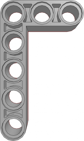

Not only new parts, but also some venerable ones like this one:

Okay so, here is more visual explanation of what I suggest to do.
Currently we have this:
It is pretty angular, not so pleasing to see, and, as Phillippe mentioned, sometimes results in pretty unpleasing geometry

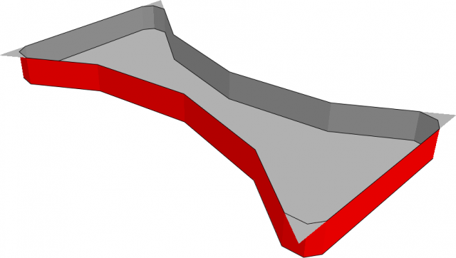

Instead, I suggest doing this:
Result is more pleasing to the eye, and doesn't have 0-thickness in any places of the part.
Mentioning once again axle primitives, we already have an example of changing primitives to make them look better, and also with the change get rid of some unwanted geometry interactions, that don't change much due to not being visible most of the time. Liftarms by the way, I want to say, are way easier to notice imperfections with, because npegholes are seen very commonly on the builds, and some smaller ones look very not good with what is currently on hands
I also attach rough concept models of primitives I used for the pictures. These are currently just the concept models, and use no primitives nor have any smoothing. I will make proper versions of those two, as well as other npeghole primitives if idea won't ultimately get rejected, but for now I think it's enough for the discussion

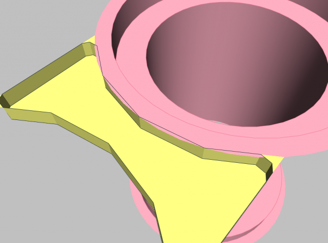

The main issue is that the suggested design doesn't work in primitive substitution mode.
Most of the holes in beams are made using the connhole.dat primitive, and when it changes shape, the npeghole has to also adapt.
Many of the npeg primitives are today made using cyli primitives.
Or all beams will end up looking like this:

I meant indeed that the small corners really don't need that many faces! As you say, non primitive corners work fine since they are so small. Attached my proposal...

Looking more closely, looks like the corner rounding should be even more prominent (Even though real shape depends on parts)

(2022-04-27, 9:43)Philippe Hurbain Wrote: It is defined as an extension of normal resolution of tang (this is the proper way to do it to allow direct normal -> hires substitution). But then at lo res this become meaningless.
As there is no prim substitution doen on the level of lo res prims, then we do not need a tang, imho.
PS: the end-condlines of 8/3-8cylo are wrong
Edit: Attached the sample
.dat   npeghole_new_rounded.dat (Size: 3.47 KB / Downloads: 7)
Reply
RE: [Suggestion] Cure the npeghole primitives
#38
(2022-04-27, 13:36)Gerald Lasser Wrote: As there is no prim substitution doen on the level of lo res prims, then we do not need a tang, imho.
You have a point... But then using a cylo has a very limited interest  Big Grin. Looks excellent nonetheless!
Reply
#39
(2022-04-27, 14:55)Philippe Hurbain Wrote: You have a point... But then using a cylo has a very limited interest  Big Grin. Looks excellent nonetheless!
I also don't see much reason in using cylo besides saving a bit of disk space.
New shaping looks better tho, I must point out
Reply
#40
(2022-04-27, 16:26)Max Murtazin Wrote: I also don't see much reason in using cylo besides saving a bit of disk space.
Yes, it's mostly to reduce clutter in the code
EDIT: But the L-Beam looks very tempting now...
