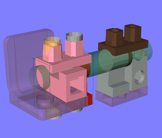

Hey,
I just "finished" the first step of the "leg rework process" Smile
The corrected hips+legs are attached to this post. The legs do not use subfiles at the moment.
edit: I updated all files on 2015-11-30.
edit2: The files are now on the parts tracker! (3815, 3816, 3817)
Here are the test scenarios from Magnus Forsbergs post
Code:
1 16 -10 -15 0 6 0 0 0 60 0 0 0 6 4-4cyli.dat 1 16 10 -15 0 6 0 0 0 60 0 0 0 6 4-4cyli.dat 1 16 0 20 0 20 0 0 0 20 0 0 0 10 box0.dat 1 34 20 12 0 0 -40 0 9.5 0 0 0 0 -9.5 4-4cyli.dat 1 13 0 0 0 1 0 0 0 1 0 0 0 1 3815b.dat 1 13 0 12 0 1 0 0 0 1 0 0 0 1 3816b.dat 1 4 0 12 0 1 0 0 0 1 0 0 0 1 3817b.dat
Code:
1 6 60 0 0 1 0 0 0 1 0 0 0 1 3815b.dat 1 7 60 12 0 1 0 0 0 1 0 0 0 1 3816b.dat 1 7 60 12 0 -1 0 0 0 1 0 0 0 -1 3816b.dat 0 // The same set-up in real parts makes it clear that the current 3816s01.dat is really wrong. 0 // It is possible to place this mock up on a 3023 in real parts, but not in ldraw-parts 1 44 60 40 0 1 0 0 0 1 0 0 0 1 3023.dat
Next steps:
- Create the subfiles
- Project existing patterns to the new legs (and fix possible pattern errors)
I estimate that it will take 3 to 4 months to transfer all patterns to the new leg.

Looking good,
But IMO the circular section of the leg has to be of the exact same size as the crutch in the hip, r=9 ldu (trans green cyli).
And I find it hard to accept the sloping backside, but as far as I can see there is no way to avoid that, without also increasing the diameter of that section. But then we have to change the hip too.

Magnus Forsberg Wrote:But IMO the circular section of the leg has to be of the exact same size as the crutch in the hip, r=9 ldu (trans green cyli)
I measured the length of the foot with a vernier caliper. It is 8mm long (20 LDU). The circular section of the leg has a diameter of 7mm (17.5 LDU).
The circular section is centered with a resulting radius of 8.75 LDU... There is a slope on every minifig leg back. Don't worry it is just 0.045mm width per 1mm height.
Rise = 11mm
Run = 0.5mm
Slope = Rise / Run
Slope = 2200%
The slope is hard to spot with the human eye on a real pair of minifig legs.
The computer works like a magnifying glass. With very high zoom and bad aliasing you will see the slope blindingly easy.
edit: On the real part there is a small line parallel to the slope on each side. This small line makes the illusion perfect, as you can see here https://ministryofminifigures.files.word...erman3.jpg

I also have the same measurements, but , as I said, the circular section has to be 9 ldu, and it has to be placed in the middle of its rotation center. Please study the model I made, and look at the frontsection of the circular leg surface. The gap between the hip and the leg is too big.
Correct dimensions are irrelevant now. We have to make the new design look good, together with the hip. Keep the size of the upper leg section in the old design, but move the foot to a correct position.
The slope is real and true and a consequense of the redesign. The old design made the misstake and ignored the slope.
