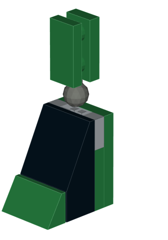

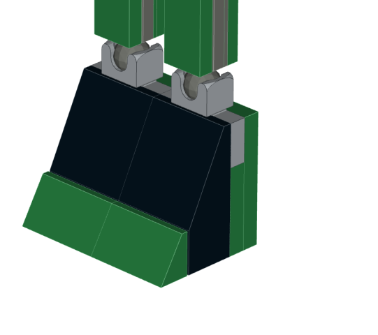

Hi all,
[Image: 9345659494_c87bf58fbe.jpg]
Tiny ball joints. by Genghis Don, on Flickr
I'm so excited about the new ball and socket parts I made them for LDraw today so LDraw users can started with them early.
[Image: 9347977958_0896fa274f.jpg]
Ball and socket by gambort, on Flickr
Tim
.dat   PlateS.dat (Size: 635 bytes / Downloads: 5)
.dat   PlateSB.dat (Size: 734 bytes / Downloads: 3)
.dat   PlateSS.dat (Size: 974 bytes / Downloads: 5)
.dat   ball1.dat (Size: 356 bytes / Downloads: 11)
.dat   sock1.dat (Size: 4.13 KB / Downloads: 16)

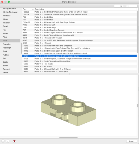

I have modified or made:
63082.dat
98263.dat
14418.dat
14419.dat
14704.dat
joint-8-balla.dat [groove]
joint-8-ballb.dat [no groove]
joint-8-socket-freeb.dat [the old square socket used in 62082]
joint-8-socket-fricta.dat [the new socket]
Please feel free to make any minor corrections at review stage. I'm not sure how much time I'll have to spend on the parts.

Magnus Forsberg Wrote:1.)
Why do the 8-ball-prim have an extra section of 4-4cyli?
I can't use joint-8-ballb.dat in part 3614.
Happy to change that one. The balla (was mis-written as balla before) will, I suspect, always be used with the cyli because the origin needs to be standardised.
Quote:2.)
I don't like the looks of the "joint-8-socket-fricta.dat"-primitive.
The pictures of the new sockets I can find show something else than the current design.
It should have rounded, softer corners and the hole is also rounded and spherical, not square or semi-cylindrical.
I doubt that the current design allow correct sideways movement.
They were made from the LDD pictures and could be wrong. Similarly I simplified some of the details to keep the file size smaller. My main goal is to get these very useful parts out in functional and useable form as quickly as possible
Functionally they work. I tested.
Quote:3.)
I don't like the extemly long file names.
As an active author working in LDDP I do most of my editing in a text editor, and don't want to type it all out every time.
Please consider a shorter name for these new primitives.
I too do everything by text. But I would prefer to use names that make sense rather than some complicated abbreviation that is unnecessarily short. I'm sure I'm not alone in typing faster than I can remember Smile
Quote:4.)
I don't like to remove the word Towball from the descriptions. It has been present for many years now and is established.
If it is removed, let's add it as a keyword.
I believe it's long been LDraw standard that names should refer to form and function, but not use. Those parts are no longer "towballs". They are now ball and socket hinges. I agree we should keep the keyword, at least in the old parts.
Quote:I'll gladly use them, but let's all agree and discuss it here, before I start integrating them.
Yes. That is why this thread exists.
Reply

I was trying to follow the discussion above but I am slightly lost. I was trying to use the mixel ball/socket joints but they do not appear correctly in Bricksmith. Are these part actually complete and correct - I have a feeling it is me and I am doing something wrong...
As you can see, 14704 doesnt appear correctly, nor 14418 and in the leg portion, I can also not get 14419 to appear.
Can anyone advise me - I would be very grateful :-)
Elspeth

Hello, I also meet the same problem as yours and cannot fix it properly although I have followed the instruction as mentioned above....or did I do sth wrong when placing the dat files?  Below is my understanding for file path of some unofficial parts.
[Image: 14704.png] 14704
"14704.dat" placed in "parts" folder and the subfile "joint-8-socket-frica.dat" placed in "p" folder?
[Image: 14418.png] 14418
"14418.dat" placed in  "parts" folder, meanwhile subfiles "14418s01.dat" placed in "s" folder and "joint-8-socket-frica.dat" placed in "p" folder?
Pls correct me if there is any misunderstanding... Thx!!
