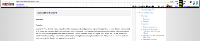

#11
(Yesterday, 15:27)Peter Blomberg Wrote: more decimals (up to 6, sometimes even 7 if motivated properly) can be used
This is incorrect. Anything >5 decimals is contrary to the library spec and this is enforced on submit.
Think of it this way: 1 ldu = .4mm. At 6 decimal places, 0.000001 ldu  = 0.0000004 mm or .4 nm which is overkill for precision. Any gaps at this level are insignificant.
Reply

RE: Request for new primitives
#13
(Yesterday, 15:56)Orion Pobursky Wrote: This is incorrect. Anything >5 decimals is contrary to the library spec and this is enforced on submit.
So the specifications have changed since a year ago?
Also, it wasn't about the vertex coordinates. It was about the rotation matrix. Sometimes, when one rotates and scales a primitive, the added decimals in the rotation matrix may be needed to achieve 3 decimals on the vertices. I've also encountered more than 5 decimals when the overall part has 3-fold, 5-fold, and 7-fold rotational symmetry. Have all such cases been updated to 5 decimals?
Reply
#16
(Yesterday, 16:36)Peter Blomberg Wrote: So the specifications have changed since a year ago?
It's always been >5 is not allowed. The only change is that the PT is now automatically enforcing this standard.
I will say that it has been unevenly enforced.
Reply
#19
(Yesterday, 17:06)Orion Pobursky Wrote: It's always been >5 is not allowed.
I'm surprised. We had lots of discussion about the x+ decimals last year, yet nobody pointed out such a limit. The specs didn't explicitly state it at the time. We came to the conclusion that 8 and 10 decimals were too many and could be the reason for a hold vote. At the time, 6 decimals outside a rotation matrix was not a reason for a hold vote.
Reply
#21
(7 hours ago)Peter Blomberg Wrote: I'm surprised. We had lots of discussion about the x+ decimals last year, yet nobody pointed out such a limit. The specs didn't explicitly state it at the time. We came to the conclusion that 8 and 10 decimals were too many and could be the reason for a hold vote. At the time, 6 decimals outside a rotation matrix was not a reason for a hold vote.
I was wrong. The >5 error limit is new.
However, there was a discussion, started by you:
https://forums.ldraw.org/thread-29110.html
It ended with the spec as currently written.
As always, I am open to more discussion on this but it should happen on that thread.
Reply
#22
6 digits were always a "bad figure". Above a "Wayback" from 2 years ago.
w.
LEGO ergo sum
