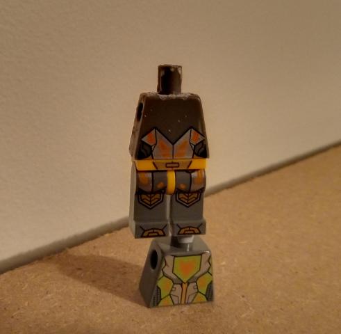

RE: 23763 axl torso
#3
(2025-06-03, 11:15)Chris Böhnke Wrote: Official meshes sometimes (or often  Rolleyes ) are like this. If it's too precise, simply round it off. Studs, Pins, etc. should all be remade to exactly fit the LDraw standards.
What's more important is the position of said pins. Can you tell where their center is? Those should probably be "in system". Though for a figure part like this, there is some chance it might be off as well (but should be a somewhat "round" number as well).
for example on the original mesh the studs are on 12.99 i have rounded it to simply 13
the pin where the arms connect is at -40.924 should it be simplifed to 40?
the flat part where the neck stud sits on isnt flat its all over the place but its mostly -52.192
i have simplified it to 52.2
i would prefer real messuarments because to quote orion "Real world measurements trump the LDD mesh."
also fun fact the part is a glued assembly between a large upper part glued very tightly on a normal minifig torso
so tight you would have to destroy it to sepreate it pictures below
(there were pics of the upper part seperated from the torso but its not available anymore iirc the part connects through the neck i think it was 23763pr0005 that was used
Attached Files Thumbnail(s)
Reply

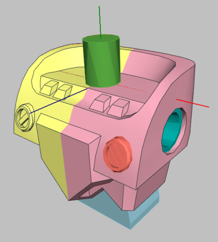

#4
To me, the mesh look really good.
Correct the origin and compare some vertices on left/right side. They match.
Add the 973.dat
Cut it in halves, make a subfile, and reduce away all unnecessary vertices. Many are on flat surfaces.
Remove the top stud, and add a 4-4cylc as neck pin. The surface around is probably flat. y=0
Replace the peg hole, and add a pinhole structure. Need a rework. Center at y=11
Seams hard to use a conhole primitiv.
1 16 20 11 0 0 -1 0 1 0 0 0 0 1 connhol3.dat
The red thing on the chest might need more work to look good. I would add more vertices to make it "rounder".
Close all the gaps around the standard torso.
Add some kind of blocker to close the internal arm holes in 973.dat.

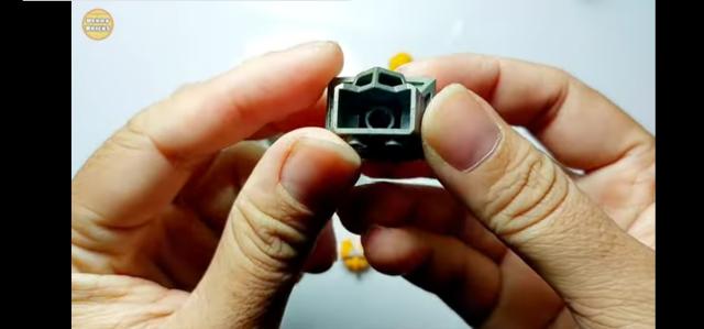

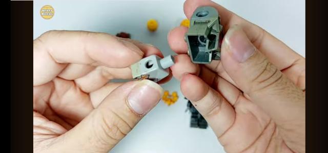

#11
(2025-06-04, 9:56)Jeff Jones Wrote: probably need internal surface so it doesnt look ugly when viewed bottom
Here you have a couple of screenshots from the bottom:
Reply
RE: 23763 axl torso
#12
(2025-06-04, 13:03)Javier Orquera Wrote: Here you have a couple of screenshots from the bottom:
Is that from a video?  Link?
Reply

RE: 23763 axl torso
#14
(2025-06-04, 17:49)Magnus Forsberg Wrote: Is that from a video?  Link?
Two videos, actually; the links: https://m.youtube.com/watch?v=4mkUjrNsN2o and https://m.youtube.com/watch?v=NODLO5sbhUA
Reply
