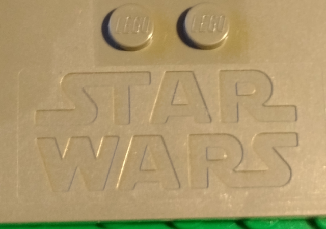

posting it here because i dont want to clutter the parts we are working on thread,
this is one of the missing 2000 parts
there are rounded edges on the letters but i have choose to omit them, maybe a simple triangle chamfer?
also i feel like the logo is way too the right
.png   stnr wanrs.png (Size: 5.43 KB / Downloads: 168)

There's an existing "Star Wars" logo which should be used here.

(2025-05-22, 10:14)Chris Böhnke Wrote: There's an existing "Star Wars" logo which should be used here.
i have checked the logo prim
the letters on the part is taller and there is a gap between star and wars logo prim cant be used

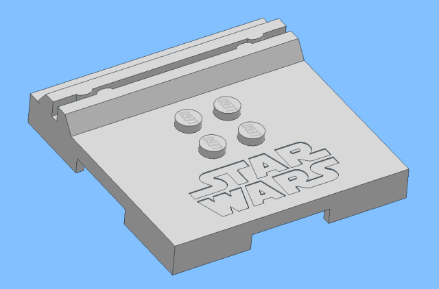

How about this (needs a bit polish still)?
.dat   30566.dat (Size: 56.98 KB / Downloads: 1)
Just noticed the studs on the base part are rotated wrong...
Update:
Fixed the edgelines, still a few gaps inside the logo though.

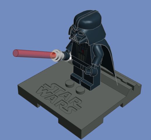

#5
finished my version
.png   Annotation 2025-05-22 165432.png (Size: 7.59 KB / Downloads: 140)
are there any issues i should correct first before uploading?
there is a tj between the bottom 2 studs and the top of star but i did that to avoid adding several thin triangles.

v2
did chris' suggestions and changed the 1-4cyli to 5-16cyli
ready to be on the PT?

Sure, why not.
You can link to this thread, so people on the PT know about the development.

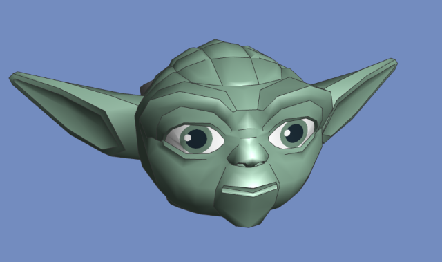

agree?
s\98106s00.dat head no patternable surfaces
s\98106s01.dat head half
s\98106s02.dat face front half
s\98106s03.dat hair
s\98106s04.dat ornaments
s\98106s05.dat ornament back
[Image: 250x250p.jpg?1658440576.0244722]
