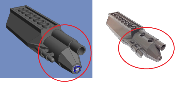

also it seems like both the drill thing on the front i a plate high and the drill holes on the bottom are missing
since its a 2.0 part requires rewrite btw

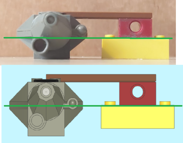

added a line to compare
looks like there is really an error...
the original part is more "squished" at the slopes.

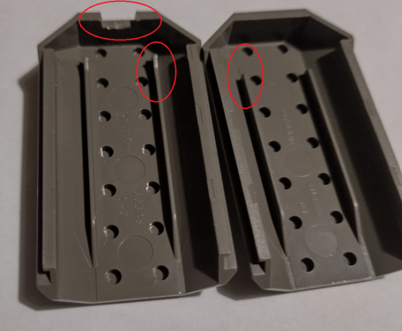

I have both versions of this part (yes, there are 2, with a slightly different battery opening).
There seems to more off than just the height. I will try to make a new model. Should I do both versions?

Quite a bit off from reality:
The current one is also too long, making it out of system. The real one is exactly 12 studs long (if you ignore the front stud).
The version difference is entirely limited to the battery lid. The prongs on the inside were removed, as well as the hole used to unlock it with a screwdriver (you can see some indentations from the previous owner being less careful  Dodgy ). Since the receiving side for the prongs on the base part is present in both versions, I assume the "hard access" version came first.

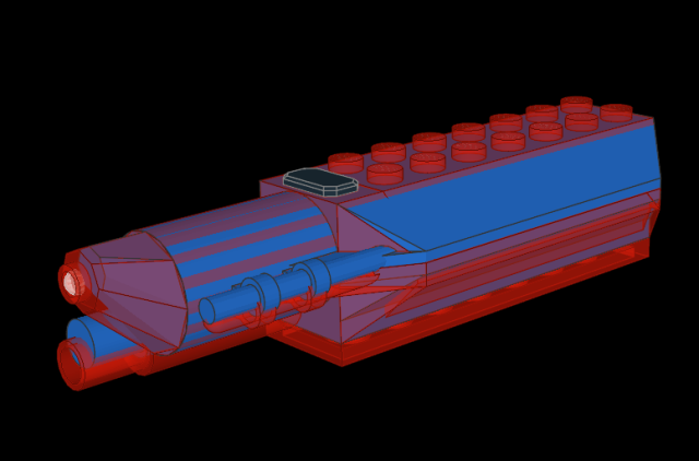

Ok, quick status update, since this is taking longer than anticipated:
  • The big complicated Bottom piece is almost finished (which was the main issue)
  • Top Cover already complete
  • Battery Cover, Button and Electronics still a bit WIP, but those are rather simple models
  • I don't see much point in uploadingan incomplete "set" to the PT, so everything will get there once finished
I really hope it's done this week, but I can't make any promises.

Ok, finally on the PT (sort of):
https://library.ldraw.org/parts/51692
Should be usable for most purposes as it currently is without much issues; just missing a few non-plastic internals.
I will add the electronics and screws as soon as I find the time.
