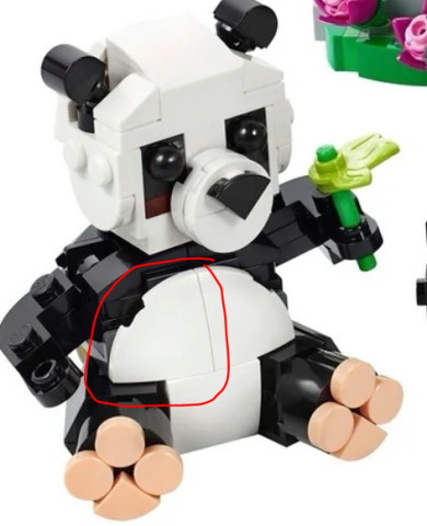

We also get a nice 2x2 round quarter dome piece

New, looks like the flat 3x3

show me it, it isnt just either of these right?

like the right one, heres a pic:

ooh ok, but in 2x2 form, yes this  is useful
