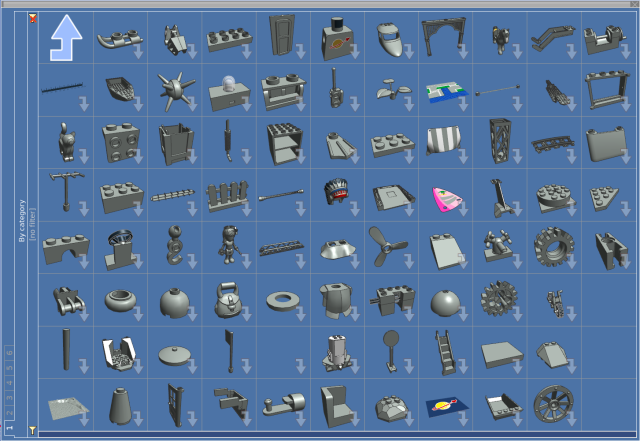

New meta in LDConfig for default category icon in editors
#1
Guys,
the following is addressed mainly to LDCad where the first part in a CATEGORY is used as mascot for it but all other editors. This leads to very strange results where "Slope" is represented by a Duplo Slope 2x2x1,5 or "PLate" by a Duplo Plate 1x2 with overhang. In LDCad this is editable through the pbg files in the AppData folder - not very user friendly.
I suggest adding a new meta to the LDConfig.ldr defining the mascot for the single LDraw categories:
0 !CATEGORY Plate MASCOT 1 16 0 0 0 1 0 0 0 1 0 0 0 1 part.dat DESCRIPTION Plates
Thoughts?
w.

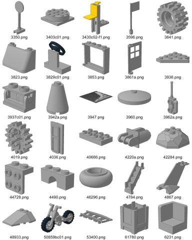

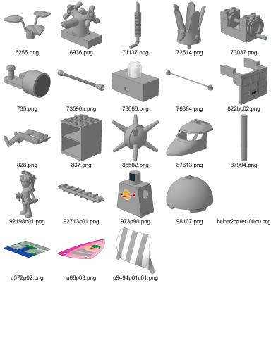

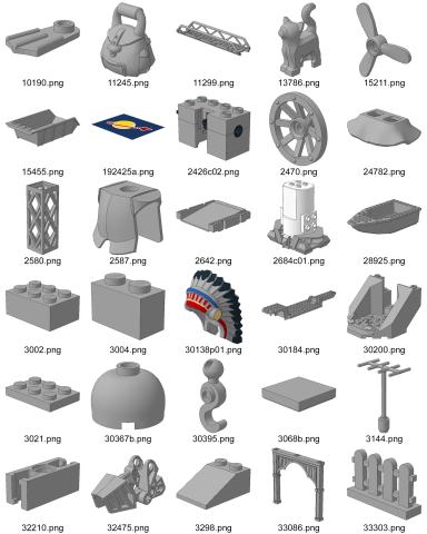

(2024-08-01, 6:41)Willy Tschager Wrote: Here is my list for the LDConfig file. Feel free to comment. Rotation is untouched as there is currently no editor supporting the AVATAR meta:
I know many partnumbers, but could you make a list with images of these parts?
Reply
RE: New meta in LDConfig for default category icon in editors
#6
Here we go:
LEGO ergo sum
Reply

#8
It is actually using it now:
The part MUST be in the pbg items list though, or it will ignore it and default to the first one in the list.
Still thinking about how to handle the descriptions and orientations though.
@Willy the brick category has a different part in your overview as compared with the preceding text (3002 and 3004), so one of them is wrong Wink
Reply
#9
(2024-09-05, 18:41)Roland Melkert Wrote: @Willy the brick category has a different part in your overview as compared with the preceding text (3002 and 3004), so one of them is wrong Wink
Will check - but man, those look freakin' awesome!
w.
LEGO ergo sum
