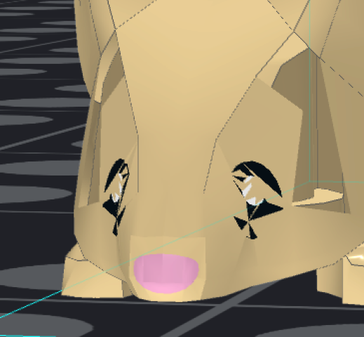

i make some mistake?
Attached Files Thumbnail(s)
Reply
RE: 35757c01pb01 Mouse with Light Nougat Tail, Black Eyes and Bright Pink Nose Pattern
#24
(2024-01-17, 15:09)Dario Wrote: i make some mistake?
I had to update 35757s01 subpart to fit eye position. Please download it again!

(2024-01-17, 15:33)Philippe Hurbain Wrote: I had to update 35757s01 subpart to fit eye position. Please download it again!
https://library.ldraw.org/tracker/34005
perfect now thanks
