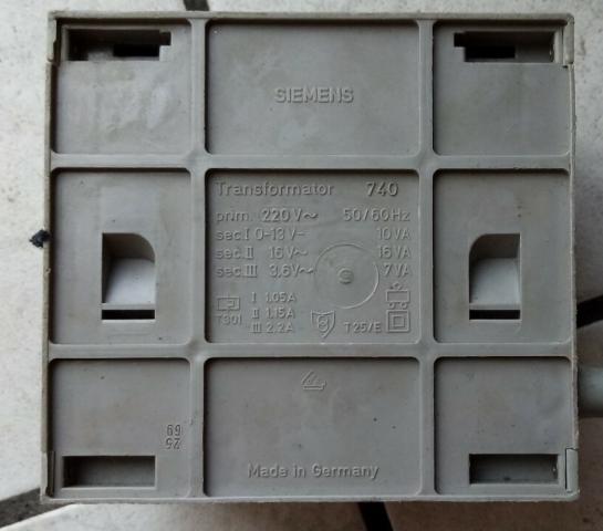

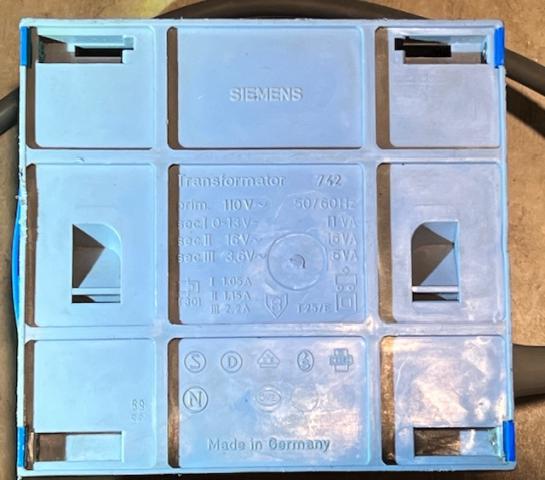

740 info on the bottom:
Code:
| | Siemens .................. | |
| | Transformator~ ....... 740 | |
| | prim 220V ........ 50/60Hz | |
| | secI 0-13V-.......... 11VA | |
| | secII 16V~ .......... 16VA | |
| | secIII 3,6V~ ......... 6VA | |
| | (lotsa electrical permits) | |=== Cable

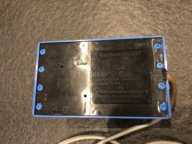

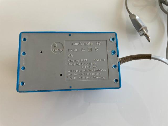

741 info (made by Bühler)
Code:
| .... Transformator 741 ... |
| Eingang: 220V~ 50/60Hz ... |=== Cable
| Ausgang: 5-7-9-12V eff.=== |
| ........ 2-3-4-5VA ....... |
| mit Schutzschalter 0,75A . |
| nur für trockene Räume ... |
| Made in Western Germany .. |

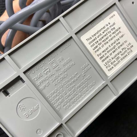

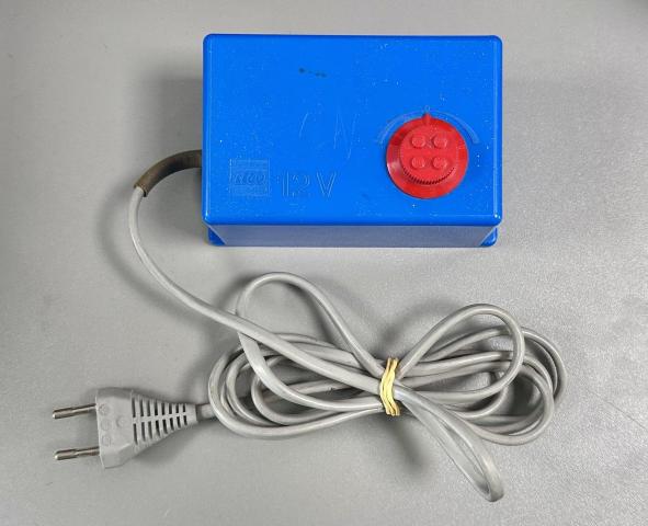

Here is an image of the sticker (there is even a second one I forgot about):
https://rebrickable.com/media/parts/phot...5cc8ae.jpg
And a few photos I made:
Reply

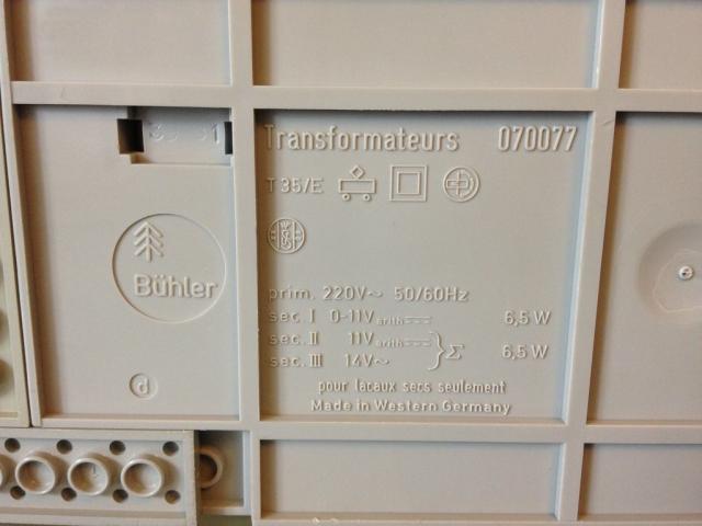

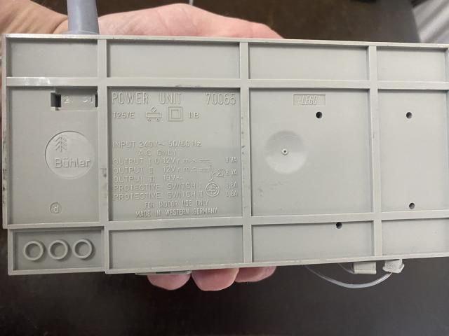

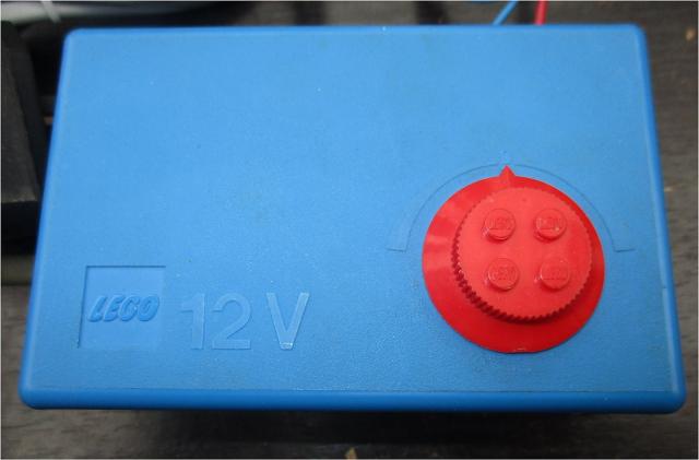

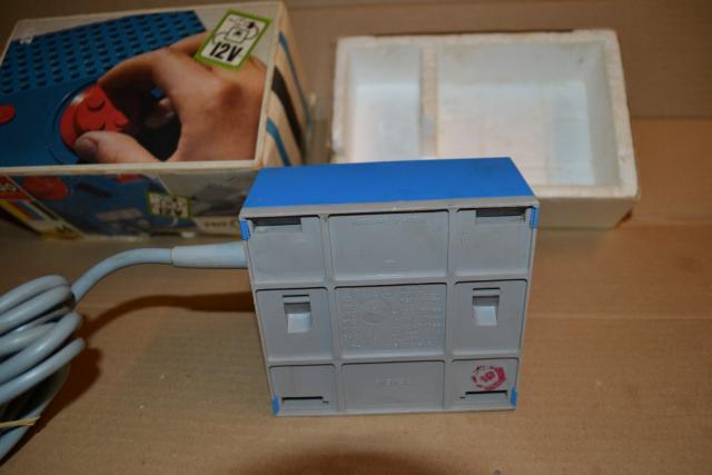

Hello; I did some "research" in the info on the bottom of the transformers and here is wath I found, with pics:
From stet 7864 and variants:
.webp   LEGO 12V 7864-1.webp (Size: 17.97 KB / Downloads: 0)
    (Country?)
Variant of the knob:
.png   lego 7864 perilla exterior.png (Size: 281.66 KB / Downloads: 46)
.png   lego 7864 perilla interior.png (Size: 249.45 KB / Downloads: 46)
Take on count that the secIII in front have 12v~ embosed and the info is 13v~; on others match 13v~.
From set 740:
.webp   lego 12v 740 azul-2.webp (Size: 162.94 KB / Downloads: 1)
.webp   lego 12v 740 gris.webp (Size: 40.11 KB / Downloads: 0)
Only color variant. Don't know the countries.
From set 741:
.webp   LEGO 12V 741-1.webp (Size: 40.38 KB / Downloads: 0)       (Metalic?)
The two logos variant:
From set 742:
This is all I can find; hope someone wish/want to do the models of the fonts.
Reply

Are these your own pictures or did you find them online?
I have 740, 741 and 7864 (physical)...
What plug does 742 have?
are 70065, 70077 and 70096 1:1 alias of 7864 or are there differences?
Reply
RE: 12V Transformers
#27
(2025-06-13, 22:51)Rene Rechthaler Wrote: Are these your own pictures or did you find them online?
Unfortunately the pictures are online, all of them.
742's plug is unknown to me.
If 70065, 070077 and 070096 are aliases of 7864, don't sure, I think it is. Other difference than you can see on the pics and what I wrote, don't know.
Reply
