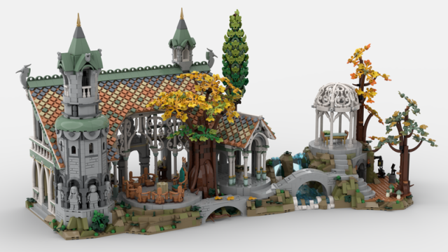

Hello, since the digital instructions are out today, I want to build the Rivendell set digitally.
But there are some pieces missing (no critical ones):
(https://www.newelementary.com/2023/02/le...rings.html)
- Plant, w/Plate 2x3x2, No. 1 (Design ID 2682)
- lotsa new Weapons (Axe, Swords, Sting, broken Narsil)
- new headgear and wigs (Gimli Helmet 2675 and Beard 2676, Legolas/Elrond Hair 100953, dual molded, like 10055p01)
- new Heads and Torsos
Edit: not new but still missing: 36806
https://www.bricklink.com/v2/catalog/cat...conly%22:0}
80497 is very similar to 43892, but still new
I think I will just build the base without the figures to add them later.

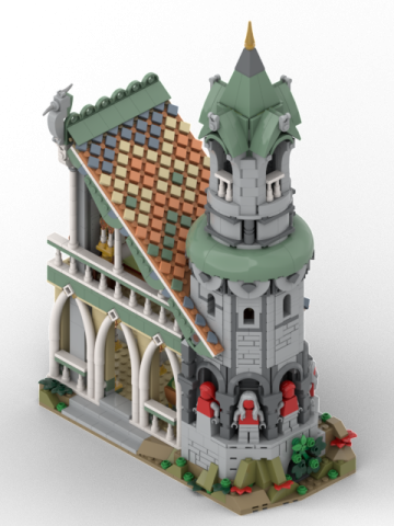

Hello, finished the first part:
built and rendered in Studio, red=wrong part, didnt use the new parts yet.
Reply
RE: 10316 The Lord of the Rings: Rivendell
#24
(2023-03-30, 19:55)Rene Rechthaler Wrote: Hello, finished the first part:
On my side, I finished it few days ago Smile But I have to update with the new parts from Philo.

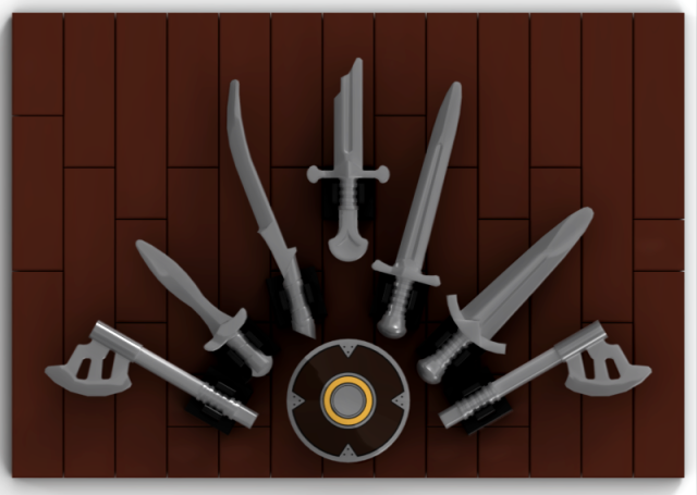

(2023-03-05, 15:16)Rene Rechthaler Wrote: - lotsa new Weapons (Axe, Swords, Sting, broken Narsil)
Weapons done!
Attached Files Thumbnail(s)
Reply

(2023-04-05, 18:21)Philippe Hurbain Wrote: Weapons done!
Awesome ! Thanks Philo !
