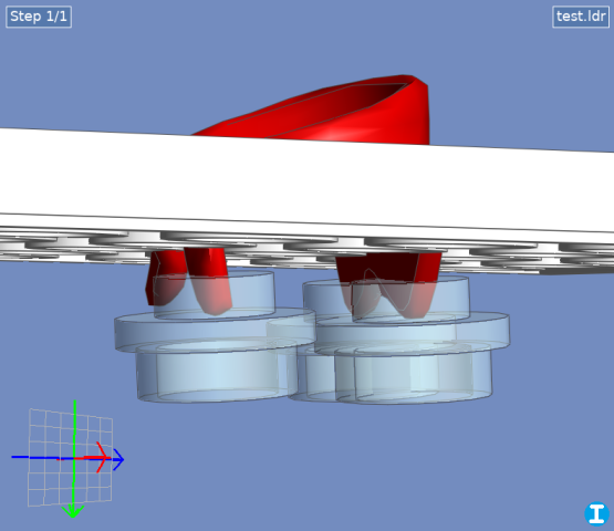

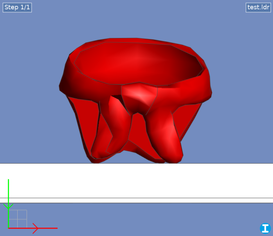

I feel like I'm under-using LDCad's advanced rotation capabilities. But instead of a question, I think it's easier to just give an example—and sort of a challenge. Smile
In the attached test file I have an oddly-shaped piece that I want to rest on the ground, here represented by a nice big tile. This part has four lower extremities, all with different y-values, and to be realistic it would need to rest against the lowest three of them. What's the best way to do this using LDCad?
.ldr   test.ldr (Size: 173 bytes / Downloads: 2)

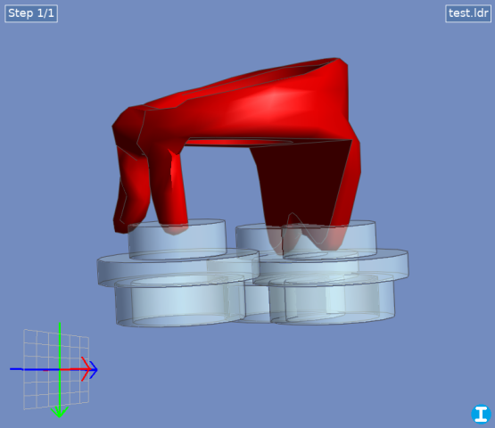

Here's how I would approach it:
  1. Find the lowest point and set it as the rotation center. You could use a helper part or a marker, but how do you find the point itself? Easiest way would be if you could directly select the vertex—LDCad can't do this, but LDPE can.
  2. Find the next lowest point the same way, then using more helper parts and some trigonometry (or the handy, but unofficial, right angle calc script), rotate the part so this hits the ground.
  3. For the final rotation, select the third low point, and rotate around a vector formed by the first two points. LDCad does allow custom vector rotation—but how do I find the vector and enter it into the rotation dialog?
Even better would be if you could select all three points at once and use them to define a plane, then set the part's absolute rotation just once so that this plane matches the ground plane. This could probably be scripted, but there's still the problem of selecting the points in the first place.
Is there a better way? How would you approach this problem?

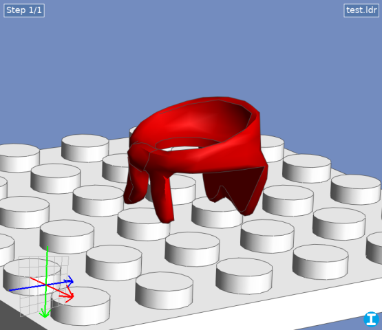

Indeed, and another thing is that you won't always have a nice level plane. What if, instead, you need the part to rest against the inside of a box with studs on the bottom? So I think of a step-by-step approach:
  1. Move the part downwards until its lowest point hits the highest point of the "receiving" part.
  2. Locate the point of contact, and rotate around this until the second low point contacts the ground.
  3. Select the first and second points, get the vector between them, and rotate around this vector to find the third point.
This might still be automatable, but it would require analyzing the mesh of both parts and tracking the successive rotations. If a certain point becomes lower than the original lowest point, it has to become the new rotation center.
Still, I think there are certain cases where your eyes will tell you that a plane on one part can be rotated to match a plane on another, and if that's the case it's nice to have a one-step process.

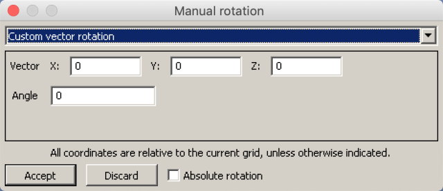

Only thing I'm still not sure of is, how can I find the XYZ values for this dialog:
Like if I want to select two helper parts, then rotate the main part around the vector connecting them?
Reply
RE: Advanced rotation techniques
#10
(2022-07-25, 21:32)N. W. Perry Wrote: Only thing I'm still not sure of is, how can I find the XYZ values for this dialog:
If you want to rotate around the x-as you would use vector 1,0,0 (or -1,0,0) just like scripts do.
The dialog was intended for using information from third parties whom often use these rotation vectors instead of an orientation matrices.

(2022-07-26, 19:16)Roland Melkert Wrote: If you want to rotate around the x-as you would use vector 1,0,0 (or -1,0,0) just like scripts do.
Oh, I see, so that's a matrix row, not angles. Maybe that tool doesn't work the way I thought!
Reply
#12
(2022-07-26, 21:25)N. W. Perry Wrote: Oh, I see, so that's a matrix row, not angles. Maybe that tool doesn't work the way I thought!
The X, Y, and Z values in the dialog are not a matrix row. They are the coordinates of one endpoint of line segment representing a vector. (The other endpoint is implicitly 0,0,0.) The direction the vector points defines the axis of rotation, and the rotation angle defines the magnitude of the rotation. Note that the only thing that matters for this vector is the direction it points, not its own magnitude. So, 1,0,0 and 2,0,0 would produce the same results for a given angle, since both are aligned with the X axis.
Reply
#13
(2022-07-26, 23:03)Travis Cobbs Wrote: The X, Y, and Z values in the dialog are not a matrix row. They are the coordinates of one endpoint of line segment representing a vector. (The other endpoint is implicitly 0,0,0.) The direction the vector points defines the axis of rotation, and the rotation angle defines the magnitude of the rotation. Note that the only thing that matters for this vector is the direction it points, not its own magnitude. So, 1,0,0 and 2,0,0 would produce the same results for a given angle, since both are aligned with the X axis.
Well shoot, I always though matrix rows were vectors. But I'd never really thought in terms of coordinates before. (This is always my problem with this stuff: I learn specific concepts for specific tasks, but I'm always missing the important bits in the middle.)
So this means, to find the values for this dialog, I could simply select the first helper part and set the grid relative to it. Then, the coordinates of the second helper part would give me the XYZ values I need to rotate around a vector connecting them.
I think.
