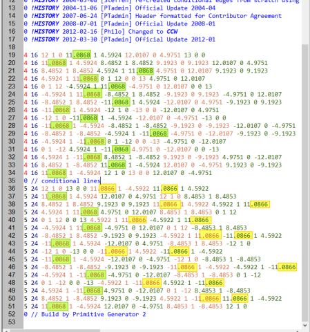

However. I have found an issue with 4-4con12.dat. The official file uses the following point in the quads:
-11.0868 1 4.5924
Such as in the following quads:
4 16 -8.4852 1 8.4852 -11.0868 1 4.5924 -12.0107 0 4.9751 -9.1923 0 9.1923
4 16 -11.0868 1 4.5924 -12 1 0 -13 0 0 -12.0107 0 4.9751
And even this conditional line:
5 24 -11.0868 1 4.5924 -12.0107 0 4.9751 -8.4853 1 8.4853 -12 1 0
However. The other conditional lines, where I expect the same point to be used, use:
-11.0866 1 4.5922
such as in:
5 24 -8.4852 1 8.4852 -9.1923 0 9.1923 -4.5922 1 11.0866 -11.0866 1 4.5922
5 24 -12 1 0 -13 0 0 -11.0866 1 4.5922 -11.0866 1 -4.5922
You can get to this point by computing the points without using the tip from this thread. With full decimals through the full calculation, the point should be:
11.08655439013544 1 4.592201188381077
which rounds to 4 decimals as:
-11.0866 1 4.5922
How do I know which method to use in conditional lines?

Edit: It seems that for a conditional line A B C D, A and B use the scaling trick from this thread, while the control points C and D do not.

(2021-04-29, 19:59)Lasse Deleuran Wrote: However. I have found an issue with 4-4con12.dat. The official file uses the following point in the quads:
I would say that the part is incorrect, and all instances of that coordinate should be the same.

(2021-04-29, 20:14)Travis Cobbs Wrote: I would say that the part is incorrect, and all instances of that coordinate should be the same.
I have now gone through all the official 4-4con[x].dat files, and these are my findings:
Of the 41 files, 10 of them have the incorrect control points. These are:
4-4con12.dat
4-4con25.dat
4-4con33.dat
4-4con42.dat
4-4con43.dat
4-4con46.dat
4-4con47.dat
4-4con48.dat
4-4con80.dat
4-4con81.dat

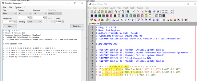

The file claims to be made using PrimGen2, but if I re-create a new version today, I get correct values.

(2021-04-29, 20:54)Magnus Forsberg Wrote: The file claims to be made using PrimGen2, but if I re-create a new version today, I get correct values.
Then it seems like an open and shut case.
I am currently on a MAC without access to PrimGen2. Are you able to generate 1-4ring5.dat and compare it to the official file as well? It also appears to have a mix of computed points. If I compute the primitive in what I believe is the correct way, then I get the point:
5.5434 0 2.2962
such as in the quad:
4 16 6 0 0 5.5434 0 2.2962 4.6195 0 1.9135 5 0 0
which differst from the official file:
4 16 6 0 0 5.5433 0 2.2961 4.6195 0 1.9135 5 0 0
The point should come from scaling the points from the simple primitives. In this case we can take 1-4edge.dat with the point:
0.9239 0 0.3827
Multiply by 6 and you get the "5.5434 0 2.2962" point and not the one in the official file!
Now. If I generate this primitive without regards to the trick, then I get another issue. I get the following quad:
4 16 6 0 0 5.5433 0 2.2961 4.6194 0 1.9134 5 0 0
which ALSO differs from the quad in the official file:
So how was this primitive generated?
Your screenshot shows both 4.5922 and 4.5924 (the reported problem).

Your first example show that the official file is not correct.
Your second example, is correct compaired to the official file, but your calculation is not.

Since the points of 1-4edge.dat are correct, the points of 1-4ring5.dat can be computed as in my previous post. Recall that the points of 1-4ring5.dat span from the quarter circle of diameter 5 to the quarter circle of diameter 6:
5 0 0
4.6195 0 1.9135
3.5355 0 3.5355
1.9135 0 4.6195
0 0 5
6 0 0
5.5434 0 2.2962
4.2426 0 4.2426
2.2962 0 5.5434
0 0 6
Which differ from the points in the official file where highlighted.
