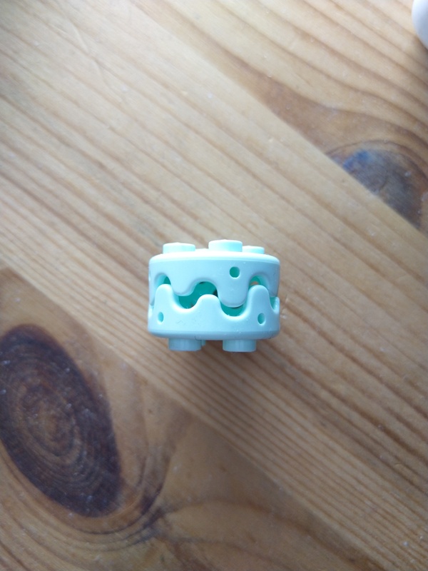

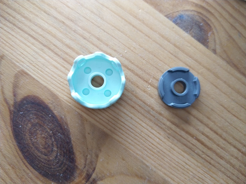

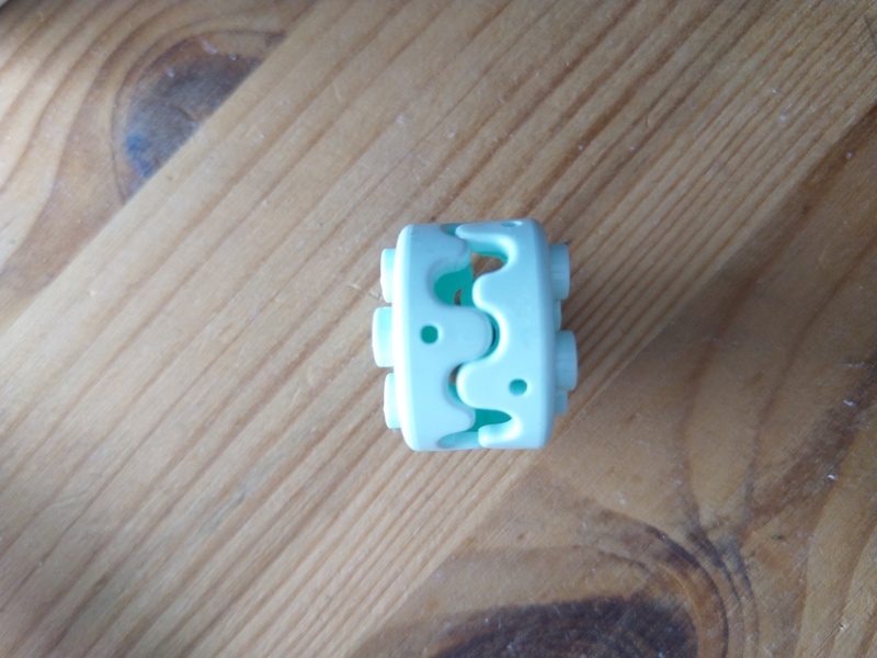

Functional details:
- a 4032 and a 3941 fit inside
- top hole is equal size and position as a 15535
- the "drops" have 2 different sizes, they are placed alternating : total 8 drops, 4 of each.
- holes on the side are on all 4 large drops and are equal the LEGO Friends attribute holes, for example like on the head of 66356 (The Lego Friends dog)
- the part is included in several sets, for example in set 41401-1.
![[Image: iYhCvltFJMTJoDpZNcW4Ydb2.jpg?f=fotoalbum_large]](https://tweakers.net/i/pIETdBWKX_ybnJzcpLENzoaEoX8=/800x/filters:strip_icc():strip_exif()/f/image/iYhCvltFJMTJoDpZNcW4Ydb2.jpg?f=fotoalbum_large)
![[Image: liqqFIseUrxoKVc5tmTx6mfk.jpg?f=fotoalbum_large]](https://tweakers.net/i/nEl9m5Dyl9P4MvRRaf1fRRAZ5LE=/800x/filters:strip_icc():strip_exif()/f/image/liqqFIseUrxoKVc5tmTx6mfk.jpg?f=fotoalbum_large)
![[Image: g8NASmjnTQheFXmv1Ke4eQfR.jpg?f=fotoalbum_large]](https://tweakers.net/i/rqTNdmz-Nce5iD3NQUxkQ4rIiGI=/800x/filters:strip_icc():strip_exif()/f/image/g8NASmjnTQheFXmv1Ke4eQfR.jpg?f=fotoalbum_large)
![[Image: UYCdl817Ma7t4vaRGTWfYlBH.jpg?f=fotoalbum_large]](https://tweakers.net/i/Gy6PeDbwSPA2oNPDZk9HWx9oEko=/x800/filters:strip_icc():strip_exif()/f/image/UYCdl817Ma7t4vaRGTWfYlBH.jpg?f=fotoalbum_large)
![[Image: E9IpaDpHuY1yXWfyvw7b4Hd9.jpg?f=fotoalbum_large]](https://tweakers.net/i/W4C4FmJuiMzDv_b5lw4KQBH9GRM=/800x/filters:strip_icc():strip_exif()/f/image/E9IpaDpHuY1yXWfyvw7b4Hd9.jpg?f=fotoalbum_large)

Reason for asking
I found a way to make them work as gears in a reliable manner (with the real pieces) and want to make use of that feature in my digital builds (stud.io), so I can share it with other people. So when implementing this part: the boundaries are important, so it can be put together like in the pictures (and they can push each other).
I also use them shifted so in the same orientation as in the photo, but then one shifted to the side, so that the sides interconnect, so it's important that the digital version can be driven in that way too.
