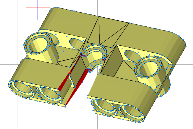

Is super useful used either as a 5th wheel or just a technic connector block.
It would be cool if it is in LDRAW but idk if anyone has it yet but,
I may buy some to use IRL so can maybe help figure out some of the geometry
I can see that it has 2x2 then 2x2 holes on the front, the inner of which are thru holes that span 3L. The two gaps cannot hold say a 1x1 beam because on the underside there is a face like on technic panels.
[Image: 67139.png][Image: img2.png]
[Image: img1.png]

Pictures and videos are a bit scarce...
I got this input, where the part is shown a bit at the 1:57 mark: https://www.youtube.com/watch?v=wxBYtpn26vM
I have added the results so far, Inside is difficult the judge
.dat   67139.dat (Size: 3.5 KB / Downloads: 17)
.dat   67139s01.dat (Size: 3.08 KB / Downloads: 15)

Try copying the files into your "unofficial parts" (67139) and "unofficial parts/s" (67139s01) folders, that should work.
I found another picture that reveals some details on the gap.
Reply

Got my part! It's finished and uploaded
https://www.ldraw.org/cgi-bin/ptdetail.c.../67139.dat
