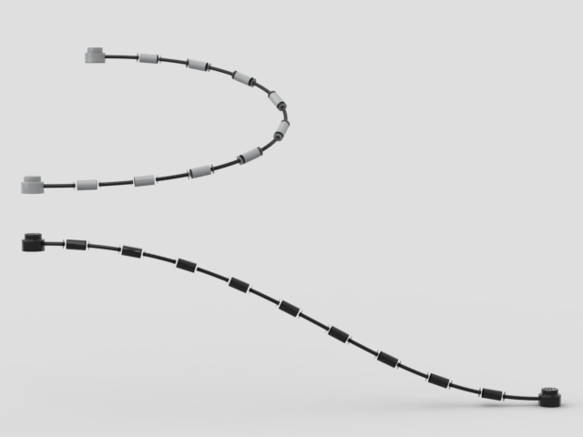

Here it is...
.ldr   stringStudsBarsLQ.ldr (Size: 3.7 KB / Downloads: 27)
Quote:In the end, I need this part to go to Stud.io too to make render of the model.
That's where there's a problem. For some unknown reason, bar segment renders badly (some stupid scaling...). Found no way to get round Sad
Problem solved, see below

(2020-06-11, 12:32)Philippe Hurbain Wrote: Here it is...
Great! Thanks so much.
For now the gaps for the render will have to do. I'll Photoshop if I have to.
I will follow your tutorial to export the generated string to Stud.io!

RE: Make 572c01 flexible
#4
Custom version of the 572c donor part, perhaps? That is, assuming you could figure out what Studio is doing weird with the scaling and adjust it in the file. I just have to wonder if there's something broken in Studio with respect to circular prims, since they're also rendering incorrectly in static parts, since earlier this year.
Other than that, I see have a little more to learn about how LDCad uses groups in path parts. :-)

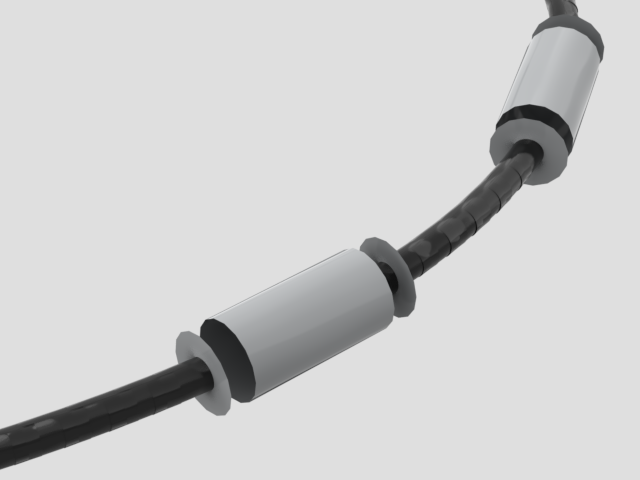

#7
So... I got the bugS!
First one was mine, I let the option "inline donor references", so the cylinder got inlined, and that scaled cylinder triggered Studio render bug that scales fake seam gap by the same amount...
As for snapping on cylinders, with current LDCad version you have to manually inline flex part (and loose LDCad editability). Loosely related to https://forums.ldraw.org/thread-23840-po...l#pid36311
Template corrected in my first post!

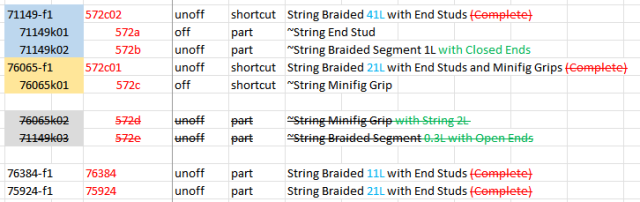

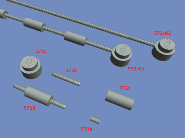

I want to renumber these parts.
572d and 572e have recently been deemed obsolete and are now deleted.
Should the base parts have the -f1 suffix, or not?
Can I go ahead, or do anyone see a problem with this?
The LDCad template need to be updated too.
#12
(2024-06-24, 19:54)Magnus Forsberg Wrote: Or do I need to make 572b obsolete, and then place the content of 572e in my new flex_section file?
Help me think here.
I think we should obsolete the old files 572a, 572b and 572c. They have been official and can't be changed, and 572b is not good to use in the template.
So, should I obsolete all three, or only b?  The other 2 could be Move to-files.
572c01 and c02 could be Moved to-files, to the new partnumbers.
Reply
#13
I'd go bold. Just obsolete. If we decided otherwise later it can change before we make it official.
I'm also not a fan of the lines as string pattern for these parts.

(2020-06-11, 14:03)Jaco van der Molen Wrote: For now the gaps for the render will have to do. I'll Photoshop if I have to.
I think the studio scaling problem is because of the 5% tolerance of the 572c segment.
Setting it to 0 shouldn't change the end result much, as the other segments have overlap.
