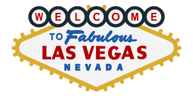

Just before I get started myself, is anybody already working on the "Fabulous Las Vegas" sign pattern from Architecture set 21038/21047?
https://www.bricklink.com/catalogItemPic...3069bpb669
And, any good straight-on photos of the part, other than the BL one above, and this one from Brickset—?
https://www.flickr.com/photos/brickset/2...ateposted/

I had it planned but never started. You can go ahead. I have other parts I’m working on. Here’s my scan:

(2020-05-13, 19:16)Orion Pobursky Wrote: I had it planned but never started. You can go ahead. I have other parts I’m working on. Here’s my scan:
Cool, thanks! Now I guess my next task is to decide how much to replicate the blotty-ness of the print…Wikimedia Commons has a very clean vector of the sign, but I'll have to thicken up those strokes and eliminate most of the negative spaces. Rolleyes
(It's going to be only a texmap version for now, so no help just yet for OMR purposes.)

I am going to try it now, since I discovered/remembered that texmap does not always work with transparency, and this part comes in trans-clear. Just gotta whip up a quick template!

I think I'm in good shape, since I was able to find a good source vector:
https://commons.wikimedia.org/wiki/File:...s_sign.svg
If anything, I could use a better sense of where the black printing is "supposed" to go (in my source photo, it's clearly offset from the matching gaps in the gold layer).
Here is my best guess so far:

(2020-05-14, 17:26)N. W. Perry Wrote: I think I'm in good shape, since I was able to find a good source vector:
I would say this pattern is perfect. The offsets you speak of are artifacts of the printing process. The letters should be centered in the white circles.

Clean-up was fairly quick with img4dat; it all depends on how fiddly you want to get, of course.
Texmapp'd and fallback'd version below; thoughts welcome. (Pattern code pending.)

(2020-05-14, 20:20)N. W. Perry Wrote: Clean-up was fairly quick with img4dat; it all depends on how fiddly you want to get, of course.
I think that you should just get rid of the TEXMAP.
A couple of reasons:
- The gold ink doesn't show correctly with the TEXMAP image (primary reason)
- This pattern isn't complicated enough to warrant a TEXMAP

(2020-05-14, 20:33)Orion Pobursky Wrote: I think that you should just get rid of the TEXMAP.
I can think of two more reasons:
  • It doesn't work in LDCad on the transparent tile
  • It doesn't work in Studio either, so it's either use the fallback or generate a custom part just for rendering
Also, should I try to optimize these triangles to quads? What's the simplest tool for that these days?

(2020-05-14, 20:58)N. W. Perry Wrote: Also, should I try to optimize these triangles to quads? What's the simplest tool for that these days?
DATHeader.

(2020-05-14, 20:58)N. W. Perry Wrote: I can think of two more reasons:
Nice!
I agree with Orion the TEXMAP version is not necessary especially as your pattern is good enough.

(2020-05-15, 6:27)Vincent Messenet Wrote: Nice!
Thanks! I've removed the texmap and optimized the file. There's one set of collinear vertices (actually just a super-skinny triangle) that I may be able to fix, but otherwise no errors are presented.
[attachment=5241]

Thanks again for the suggestions. The file is now on PT:
https://www.ldraw.org/cgi-bin/ptdetail.c...69bpt7.dat
