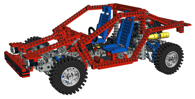

Hi there,
this time it's the 1988's Test Car Technic model 8865. It should be OMR compliant, but there are known issues:
- Small mismatch for 16-technic-brick (3703) which connects the front frame to the roof in the last step. As far as I can see and calculate with CAD, this seems to be "desired margin" in the real build. Did I something wrong, is there a way to make it look "better matching"?
- The steering axle angles with two universal joint (2x 3712+3326b+3712) in steps 16/17 are not acceptable. I looked at the angles provided by "Selection Info" without luck - I will fix this as soon as possible and would welcome any suggestion.
Done with LDCad 1.6c (Linux64).
Thanks in advance for any improvement suggestion! Smile
Regards
Stefan

The “mismatch” you refer to is exactly the scenario that prompted me to post this thread.
And in my own 8865 model, the u-joint issue was handled using the advice given in this thread—which was inspired by my efforts to build the original Auto Chassis.

Thank you so much, this was exactly what I was looking for. Smile  I will update my model accordingly.

Now done and updated, thank you very much.  Smile
Remaining known issues: none Smile
Regards - Stefan

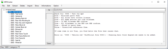

Hi Stefan
Following Problem:
There is a Part (submodell) missing:
Johann
Attached Files Thumbnail(s)

(2019-12-26, 21:11)Johann Eisner Wrote: Following Problem:
Hi Johann,
thank you very much, attached is an updated version - the missing part was intentionally deleted because it was empty. I missed to delete the part ref...
Best regards

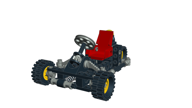

8832 Roadster - B-Model Trike
.mpd   8832 - Roadster - Trike.mpd (Size: 14.37 KB / Downloads: 5)
OMR compliant
Missing items: none

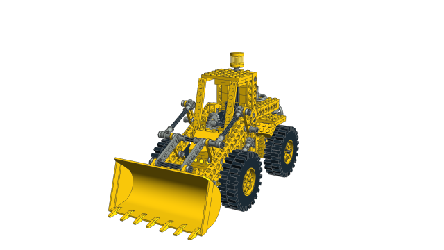

8853 Excavator
.mpd   8853 - Excavator.mpd (Size: 18.75 KB / Downloads: 5)
OMR compliant
Missing items: none

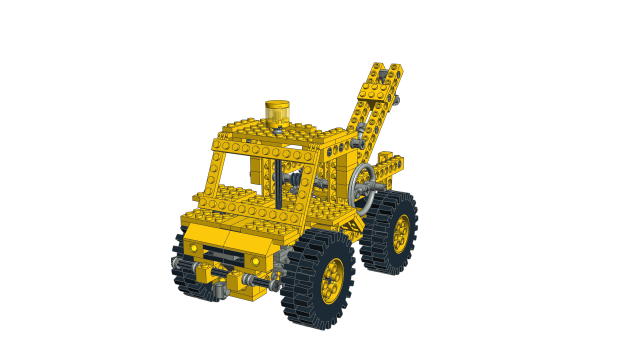

8853 Excavator - B-Model Tow Truck
.mpd   8853 - Excavator - Tow Truck.mpd (Size: 15.73 KB / Downloads: 5)
OMR compliant
Missing items: none

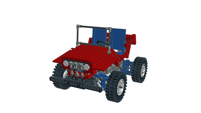

#10
8865 Test Car - B-Model Jeep
.mpd   8865 - Test Car - Jeep.mpd (Size: 31.19 KB / Downloads: 5)
OMR compliant
Missing items: none
