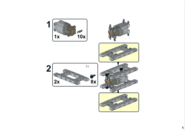

Hi guys
After a long break, I work once again on a new building instrution for a MOC from a friend.
When adding submodels to the mainmodels, they are not shown in the main model.
This problem is on LPub3d - 2.3.6
Have download now the version 2.2.1, there is no problem.
Have anyone an idea?
Version 2.2.1:
Version 2.3.6:

Hmm, strange. Can you PM me the LDraw file? I'll take a look.

OK, I have a few versions of LPUb3D running. In all versions the model and all submodels renders just fine.
Taking a look at the structure and hierarchy of the model and its contents I cannot spot anything that could cause this problem.
You might want to try to clear all caches and make sure all folders and generated images and files are gone. I.e. delete the LPub3D folder manualy.
Using multiple versions of LPub3D sometimes causes files that cannot be found by the other version or are not overwritten.
Also, remove LPub3D formatting and start over and see what happens.
I'd advice you to use version 2.3.7
The only thing I can think now of is the use of spaces in file names that messes things up.
My experience sometimes shows that LPub3D cannot handle this too well in some cases.

You might want to consider turning the submodel 180 degrees too since now it is displayed the other way around compared to how you would attach it.

(2019-04-02, 7:03)Jaco van der Molen Wrote: You might want to consider turning the submodel 180 degrees too since now it is displayed the other way around compared to how you would attach it.
Did you do a second submodel?
So you get two callouts or is there a new feature in LPud3D?

(2019-04-02, 14:41)Johann Eisner Wrote: Did you do a second submodel?
That is not new but needs manual editing. Been there since the beginning of LPub.
No new submodel, but just separately called out.
Like so:
0 !LPUB CALLOUT BEGIN
1 0 0 -40 90 1 0 0 0 1 0 0 0 1 mxxxx - sub1.ldr
0 !LPUB CALLOUT END
1 0 0 40 90 1 0 0 0 1 0 0 0 1 mxxxx - sub1.ldr
0 !LPUB CALLOUT END
Without the pointers.

Ahhhh....
I understand now.
Thanks.

Just choose Convert to Callout when the submodels are encountered and then manually edit the metacommands.
LPub converts 2 or more of the same submodel right after each other to one callout with x times used indication.
The behavior is similar to where you would use the same submodel in later steps in the model.
The only thing that you cannot do is display the callout in different ways, i.e. with rotation steps.
Since you work in the same submodel of course.
