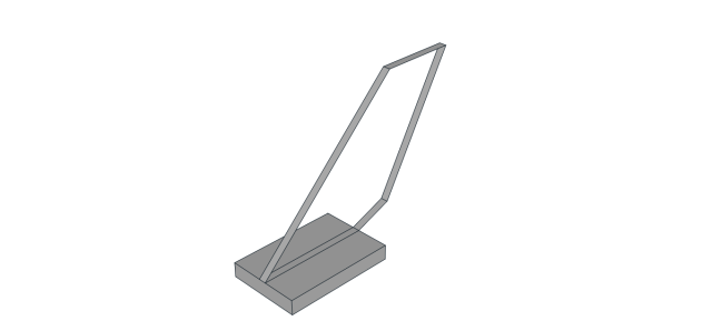

#6
One more question, for sure.
I've done a little research now.
So far, there are two parts that are printed and I suspect it will be even more.
Would it make sense to move the part 6239.dat (without side surfaces) into a subpart --> 6239s01.dat . (see Attachment)
That way we could make printed parts better in the future.
Regards Johann
Attached Files Thumbnail(s)
If nothing goes right, go left.
Reply
RE: 43218
#7
(2019-01-13, 14:24)Johann Eisner Wrote: Would it make sense to move the part 6239.dat (without side surfaces) into a subpart --> 6239s01.dat . (see Attachment)
Yes, that's the way it should be done. Also send the updated 6239 (using subpart) to Chris...
Reply
RE: 43218
#8
Done.
Reply
