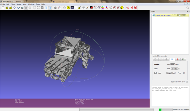

(2018-03-15, 21:44)Leonardo Zide Wrote: Have you tried exporting COLLADA?
I just tried it, and the output is very broken when viewed in MeshLab.
I think this is the MeshLab importer, I see a lot of errors in the console that show it's not parsing the file correctly. You can try exporting a 1x1 brick and filing a bug with them.
