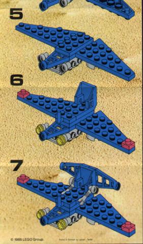

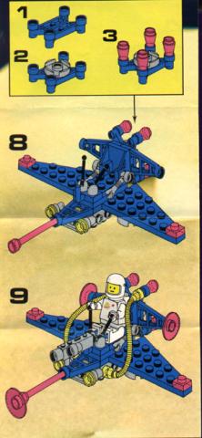

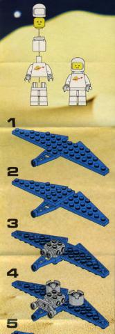

I'm new here, and just discovered this whole idea of creating digital Lego files and such. That said, I thought I'd at least try my hand at recreating a couple of my old Space Classic kits (especially since the original instructions were starting to fall apart). This is the first one I tried:
6825-1 - Cosmic Comet
I used LDCad 1.5, and then used MPDCenter to check/update for OMR compliance. At least I THINK I did it all correct. If there's something I did incorrectly, or need to change, don't hesitate to let me know. I'd like to learn on the little ones before I go crazy on some of the bigger models my kids have!
