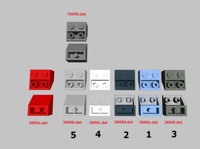

Using the Rebrickable page as a base, I made this image.
I think we should use Flat Bottom Pin, or just Flat Pin. Flat Pin was used on the Plate 1x2, 3023a.dat.
I want to change the description of 76959 to "... with Hollow Bottom Pin". (btw. the subfile is also missing "... without Front Face").
And we should add the missing hollow pin design in 76959. We can't have it in the description and then not model it.
I also think Rene is correct. The a-version doesn't exist. Rebrickable have the best summary and it only has 5 versions. Not 6.
So how should we handle our a-version?
I suggest that we change 3660a to use the design in e-version, and move f-version to 3660e.
Reply

Searched my collection of Slopes and found at least one more version (but these parts are so rare we dont need them on the PT):
-3 slopes with round pin, medium holes and extra wide curved lip (would go across the stud but has normal hole to the inner slope)
-1 slope with small holes and bottom ridges from the newer versions (I guess it is a mismould, also the logo is upside down compared to all other ones)
apart from that, its hard to define a "standard" version because they have been used for a long time...
f was the first standard, then c and then b. d and e are exots (i have 200+ 3660 and of these only 7*d and 8*e. the rest are equal amounts of b, c and f.). Then I would say make f the new a version.

(2023-10-24, 21:37)Magnus Forsberg Wrote: I suggest that we change 3660a to use the design in e-version, and move f-version to 3660e.
This is wrong.
We can't change 3660a to look like the e-version. That would break backwards compatibility. We should obsolete it.

Hm, 3660 already has been obsoleted (replaced with 3660a)...
Then we also have to check all existing prints (I think versions b and c should be swapped in the prints).
For example, 3660bp01.dat is now b (the most modern) but should be f (I already did that as 3660fp01.dat).
I have 3660bp01.dat in blue version f and 3660bp01.dat without the white rim (3660fp02.dat) in white version f and c.
Anyone else having some more printed slopes?
(and if we dont have enough work, the inverted slope 1x2 3665 also has a old version with small hole)
René

Any progress here?
I would say to use the B or C as the new standard (most used, best compability)
the A version needs to get obsoleted (doesnt exist)
F is common in old sets (does anyone have a clue when the change was)
D, E and G are Exots (exist, but are rare)
Reply

Here is my summary of what has been done.
Suggestion:
I think we should unify the the 3 uncommon versions, e, f and g, and add the differences as Help info
2025-03-18 Edit:
subfiles f and g have been removed from the Part Tracker.
Attached Files Thumbnail(s)
