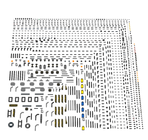

Does anyone have a tool or script that would take a standard LDR or MPD file and then create a new LDR file that contains all the parts from that model, but lay them out in nice neat rows? The layout as shown below is the kind of thing I'm after.
[Image: v9-2.jpg]
Ideally the script would have some sort of bounding box method to intelligently position the pieces.
As an alternative, is there a script or tool that can analyse the pieces in an LDR file and generate an output like this (ideally as a new LDR file)?

FYI: I've made the first picture by placing the parts manually in MLCAD.

Your second picture is basically a BOM as in LPUB.
However the BOM Pictures are not all the same size, they are in relation to each other.

Checkout My little tool:
https://github.com/zzjin/ldraw_explosion
[Image: car_origin.png]=>[Image: car_explosion.png]
