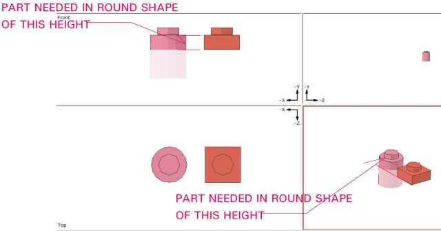

Hi Everybody,
I am a new guy here and looking for a part which is very simple.
The brick size is 1x1 in round tube with stud(diagram in pink) but height is as the orange square brick show.
Can any one local this part for me ? Or help to creatr it.
Truly thanks for help.
Andrew

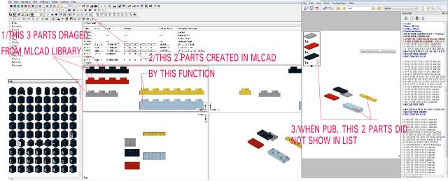

Re: some parts is not shown in PUB, can anybody help ?
#6
1/THERE ARE 3 PARTS DRAGED
FROM MLCAD LIBRARY
2/ANOTHER 2 PARTS CREATED IN MLCAD
BY THIS FUNCTION
3/WHEN PUB, THIS 2 PARTS DID NOT SHOW IN PUB LIST.
May anybody help ?
thanks.
Andrew
Attached Files Thumbnail(s)
Reply
#7
Hello Andrew,
The parts that you add with the Plate Generator are assembled within MLCAD using LDRAW Primitives likes "stud.dat" and quads etc. They are not added as a "part" itself. The primitives themselves are not listed in the part-list as they are within the MLCAD SKIP BEGIN/END bracket.
For models you want to publish I would refrain from using such hand-made parts.
If you need to use them however do the following:
- Create your plate with the Plate Generator
- Save it e.g. "Custom_2x6x2_Plate.dat" in your UNOFFICIAL parts directory
- within LPUB add the following code before the MLCAD SKIP_BEGIN statement:
0 !LPUB PLI BEGIN SUB Custom_2x6x2_Plate.dat
- Still in LPUB add after the MLCAD SKIP_END statement:
0 !LPUB PLI END
This will instruct LPUB to use a different part in the partlist for the items between PLI BEGIN/END
Gerald
Reply

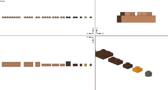

#13
Dear All,
Those are parts I wish to find out. Many thanks
Andrew
Reply
#14
Hello Andrew,
apart from the 1x1 round plate you already requested above, these are all standard plates,
which are available from the official library.
I think you have just taken the wrong path from the beginning. It is not necessary to generate such plates
using the plate generator feature. That one is only intended for cases where the official parts are not sufficient.
You should be able to simply use the official existing parts.
If MLCad does not show you these, this might have different reasons, among them
- a broken parts library installation
- a broken parts.lst file
To make sure that these problems are not present for you, please re-download the complete parts library from
http://www.ldraw.org/downloads-2/downloads.html by clicking on "complete.zip". Expand that file to your ldraw directory.
It will supply you with all officially released parts.
After that, update your parts.lst file to properly contain a list of all parts available:
- open a command prompt window by executing the command
cmd.exe
- change into the folder of your ldraw installation, by typing
cd /d C:\LDRAW
- run the program "mklist", which updates the file parts.lst for you by issuing the command
mklist
- when prompted by which criterion to sort your files, hit "d" for description
- restart MLCad.
You should now be able to use MLCad's parts tree to the left to use the plates you need.
You can colorize them as needed by using MLCad's color buttons.
