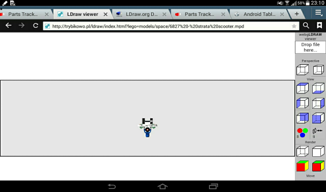

I just had it run on my Android tablet. I discovered these problems:
The fixed layout doesn't fit to my screen, I have to scroll the browser to see all buttons at the right.
The "mouse", i.e., finger touch sensitivity when rotating the model is too high,
I can not really control it, it jumps around weirdly.
I am missing zoom out and zoom in buttons OR support for using my fingers for that.
Attached Files Thumbnail(s)

My main browser if firefox, and I rarely check compatibility. One thing that I were aware of is problem with iPad safari, but I don't have one to fix it.
Thanks a lot for checking :-)
---[ status ]---
I fixed compatibility problems with:
- windows: seamonkey,
- linux: firefox/mint (probably will fix ubuntu issues),
- android: chrome.
I also added: support for touch events on android tablets.
Currently I don't have good idea how to handle smaller screen sizes with fixed layout on android. It will be probably not a problem when I will introduce floating toolboxes. One hint that could help: use vertical orientation of tablet, it fits nicely then.

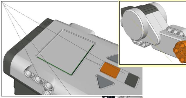

In Chrome however when I go into wireframe mode it looks like below and then I can't ever get back to solid mode:
[Image: Screenshot%20from%202014-11-22%2018%3A29%3A06.png]

I reproduced the issue. It is caused by optional lines shader. Once the optional shader program is in use, no other shaders appear to produce any output. This is what is visible on your screenshot: only optional lines.
I do not see any particular reason for it to behave weird. Possibly this is due to opengl driver in linux chrome. Optional lines vertex shader uses more parameters than usual (4 <xyz> vector points instead of 1), and I know that at least one other configuration (safari@iPad) does not support it at all.
My reproduction setup: chrome@ubuntu 12.04.05 under virtualbox, fresh install.
I will try to figure out what is wrong and if it is possible make it working.
Any hints appreciated...

The edges aren't fully working for me too (on seamonkey), they look somewhat corrupt or out of order or something.
I do like the animation, is the behavior of 'oilrig' scripted or is it a generic solver?
edit, a pic of what I mean concerning the lines:
.png   lines.png (Size: 126.23 KB / Downloads: 27)

Maybe you could put a small icon in the corner of the screen to toggle the command bar on and off?
Also, can the command bar be configured to be minimized/hidden initially?
BTW, the frame rate is very good.
Reply
Re: [webGLviewer] - Yet another WebGL viewer
#31
I've reversed wheel for chrome. Not sure if it will work for SrWare Iron. (hopefully it will)

- Edge lines seem much better with Seamonkey (antialiasing?)
- But on some parts (NXT itself, NXT motor) I get stray lines (from several spots inside NXT to origin I guess) that I don't see in Chrome.

I cannot reproduce:
- stray lines... could you provide a screenshot(s)?

- Here is composite image for the stray lines I see in Seamonkey:
- Indeed PDF creator works fine here. I was afraid to get page breaks in the middle of images, as it occurs so often... Nonetheless, saving directly images gives more freedom.
