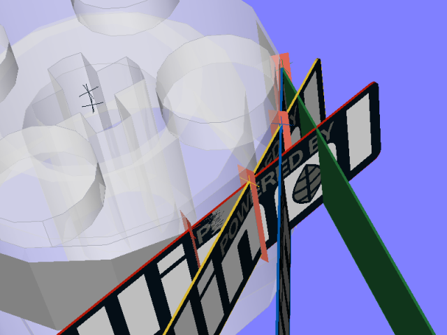

#3
It can't be too difficult?
Don't use any projection. I would do something likt this:
and then start cutting it apart.
btw, there's a small hole in the lower part of the B.
I have retracted my Cert-vote. Sorry

#4
Yes, I used this method in the past, for the sticker of Matrix Robotics motor. Take the flat sticker, move it by the width of cylinder facet (don't forget to account for sticker thickness!!!), slice using symsplitter, rotate by facet angle and iterate... tedious, but works fine...

#5
That's how I tried to do, but how do you manage the fact that there is a thickness and that the lower surface will be "smaller" than the upper one (don't know if you see what I mean)?
I tried to do everything in MLCad, which is not really convienient. What tool would you suggest ? Magnus : what software are you using in your screenshot (unless it's Ldview)?

#6
Yes, the diameter of the backside surface must be smaller than the diameter of the frontside surface.
Think of it as a thick wall. Remove a triangular section on the backside, but leave the frontsurface untuched.
Then you're able to bend it.
Do you see were I have placed the rotation points? They're placed 20.25 ldu from the origin of the file.
I then use that point as a new rotation point to rotate the sticker into the next position.
I do most of my editing in LDDP and have LDView as the viewer.
Rotation is easier to do in MLCad, since that editor allows me to use the first selected part as the rotation point.
Reply

#7
Thanks to your advices, I've managed to come to that.
I'm sure it's not perfect, but maybe good enough to be certified... ^^

#8
Yes, it looks really good. I'll cert it.
But it is now possible to continue with this pattern. The cutting process has created a lot of unwanted vertices.
You could create a template in LPC, and import the surface from your file,
and remove all the unwanted vertices,in triangles and quads of the same colour.
Another way is to simply flatten this file, import it into LPC, remove the vertices, and then use SlicerPro to project it on a 20.25 cylinder.
