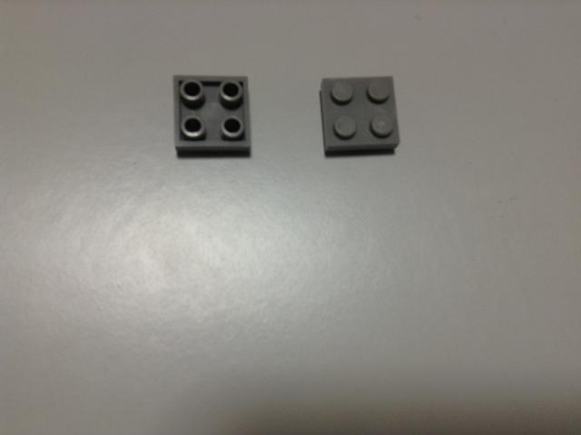

I am using MLCad to design my train, and I want to use part in attachment, but I can't find it in parts list, does anyone tell me what is this part name of number?

This is a well known Megablock part!!! Wink
Not in LDraw library...

As Philo mentioned, this isn't a LEGO piece.
But it was quite simple to create it.
I attached this part.
/Max
PS.: I never thought, that I would do a non LEGO Part here ;-)

Isn't it supposed to have a thickness higher than regular plate? See http://www.eurobricks.com/forum/index.ph...ntry941542

I used the 'simple' LDDP text editor.
Wrote:
Code:
1 16 0 0 0 1 0 0 0 1 0 0 0 1 3022.dat
for getting the regular 2x2 plate. Then I used the inline function and removed the stud4.dat. Afterwards I added a stud2 group 2x2. And scaled this group at the right position.
