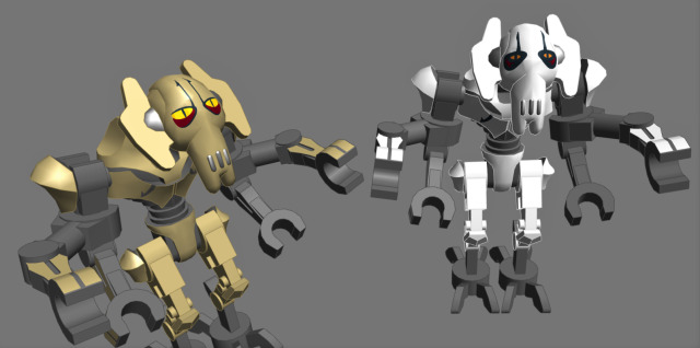

I am working on General Grievous minifig. And I have a problem.
1. How calculate angle of clips, to replace them with primitives.
2. What primitives will be better to use.

I try to model versin from set 8095. I put parts of the model in first 2 posts. But they are uncomplete. I have to raplca clips with primitives. But all clips are situated with different angle. So I need help to find angles of clips.
Reply
Re: General Grievous( need help)
#6
I don't think you can really replace whole clips with primitives (there's so many different designs...). IMHO the best thing you can do is to replace the inner cylinder and edge with cyli/edge primitives, align them visually with MLcad (See example attached). Then rebuild the clip tip around primitive.

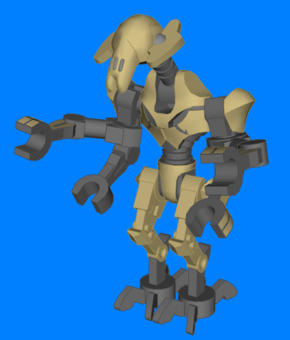

I finally got around to having a go at creating this model myself. Attached is my LDR file. The angle of the arms is not perfect (it was the best I could do in MLCAD). Is there a better tool I can use that will "auto-snap" the clips.
I had to put him in a walking stance, as when standing straight his feet seem to slightly overlap.

(2021-04-28, 6:18)Reuben Pearse Wrote: I finally got around to having a go at creating this model myself. Attached is my LDR file. The angle of the arms is not perfect (it was the best I could do in MLCAD). Is there a better tool I can use that will "auto-snap" the clips.
Sure there's a (MUCH) better tool: LDCad! Unfortunately, as Grievous parts are still unofficial, I had to create their connectivity!
...and yes, there is a problem with the legs, as I mentionned -ouch- 10 years ago! https://www.ldraw.org/cgi-bin/ptdetail.cgi?s=87569
Attached a running Grievous and connectivity files.

All printed parts are now at the Part Tracker
https://www.ldraw.org/cgi-bin/ptscan.cgi...ope=header
The attached model is not correct, since there's no snap info on the files.
The model from Philo above, have the torso reversed, and I have changed the subfile structure.
