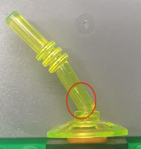

(2020-10-08, 20:01)N. W. Perry Wrote: I was actually thinking of these:
Just inverted half-cylinders (with a spherical end), I think? Can't quite make it out from photos.
Also, is the top of the stud2 flush with the rim of the dish? Or is it actually recessed a bit, as in the LDD mesh?
Ah, yes, now I understood, a picture is worth a thousand words :-)
This is in my opinion a molding artifact. The hollow stud is terminated with a smaller hole (smaller than 4 LDU) and this extends a bit further into the part and interestingly around the corner. I guess as the plastic cooled down this was pulled "inside" I should have another one as well to verify how this looks in different parts.
So no, it is not a ridge, the part is as the LDD data shows, a normal bar diameter.
Reply

(2020-10-08, 20:21)Gerald Lasser Wrote: Ah, yes, now I understood, a picture is worth a thousand words :-)
Ah, so it's completely internal—that's why I couldn't work out how it aligns with the dish spokes. And that's great, because I was kind of thinking about skipping that bit anyway.  Tongue

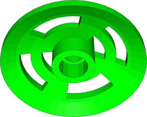

Thoughts? Does the dish look rather too thick at all, especially through the cutouts?
I know there are some edges missing, and I need to fix the a-rings…and then figure out how to join the angled part of the bar. Confused
On the plus side, we get four new hi-res ring primitives because of the 1/12th ratio of the spokes. Big Grin

(2020-10-12, 5:54)N. W. Perry Wrote: Thoughts? Does the dish look rather too thick at all, especially through the cutouts?
I would make it thinner, the 2x2 dish available is around 2.4 LDU think, go in that direction

(2020-10-12, 11:36)Gerald Lasser Wrote: I would make it thinner, the 2x2 dish available is around 2.4 LDU think, go in that direction
Here's how I constructed the handle, you can then basicall replace the "top" file.
The file includes a LDD overlay.
Yes, I think it should have the same overall proportions as the 2x2 dish. The bowl just a bit thinner/shallower, and the collar around the shaft a bit taller. Overall height 12 LDU (it's now 12.5, so that's negligible).

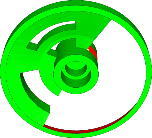

(2020-10-12, 15:48)Gerald Lasser Wrote: yes, sorry, I did not reply on this, the stdu2 is flush with the rim
There, I think that's a little more like it:
I had to deconstruct the stud2 primitive in order for it to mate with the 48 prims. That won't cause an issue, will it?
